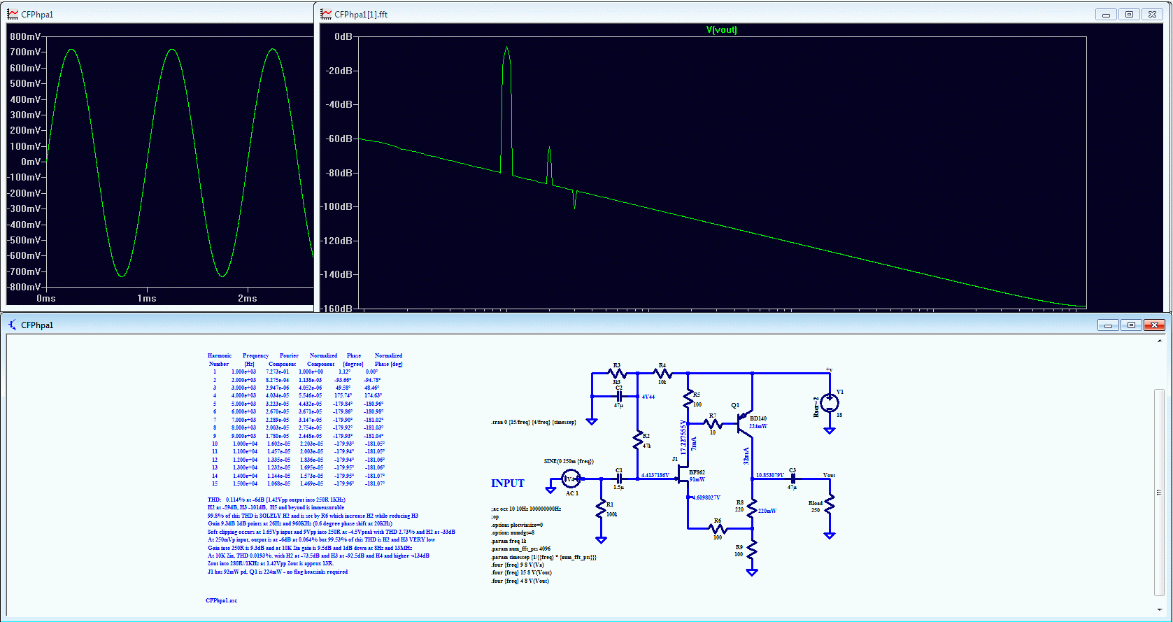

If you get a chance Hugh, please post schematic of what you are contrasting above. I redid the measurement a third time. Now with fresh batteries and sitting in a different room. Matches predictions even more. THD according to RightMark is now only 0.012%. Do I need to re-tweak it for more H2? 🙂

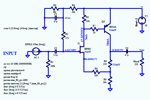

Hi X,
I have spent some time tuning my CFP headphone which, when looking through my records, I designed in 2008!!
By putting degen onto the source of the nfet, you can increase the H2 whilst reducing slightly the H3. The THD figures are quite high, but 99.8% of the thd is only H2, so it should sound very tubey.
By setting the operating point of the collector of the BD140 slave, you can optimise the dynamic range. I find this starts to distort near clip at around 9Vpp into 280R, and while I have set it at 32mA through the slave and 8mA through the master, it would drive down to 64R headphones very well. For lower impedance cans, you would need to increase the slave current to 80mA, but of course battery life would be much lower. You could also drive this at only a single 12V battery, NiCad or LiH, with slightly less dynamic range.
Advantage: very cheap parts and manipulable distortion profile with just two transistors.
Hugh

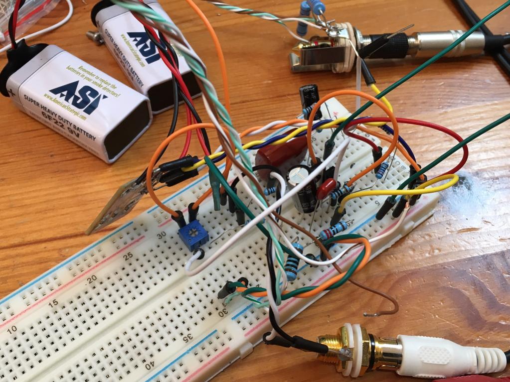

JFET-BJT Headamp with Niceness Knob Works!
Ok, I had some time and thought I would whip this up on a solderless breadboard first as the last time I did it on P2P veroboard it did not work. Well it works well and gets quite loud too so I obviously had something wrong the last time I did it. I am using 2SK170BL and all through hole components this time. I put a 100R trim pot in series with a 47R resistor to get a baseline 100R +/-50R adjustment range for the niceness knob. The solderless breadboard is kind of flakey - noisy with occasional crackles due to poor connections. So I will have to wait for a more permanent amp before measuring FFT and adjusting "niceness" knob. I know it works now so may just go ahead and hand-etch via Sharpie a small PCB for through hole/SMT as the SMT resistors are way easier to solder and require no drilling. I will probably make this as a "tea box" sized amp - a bit bigger than mint tin just because.
