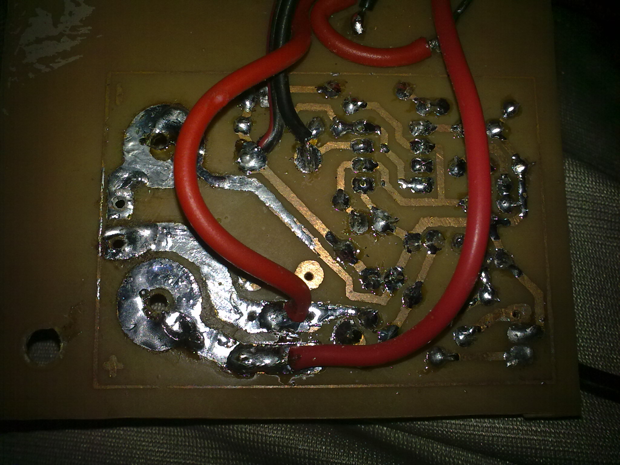

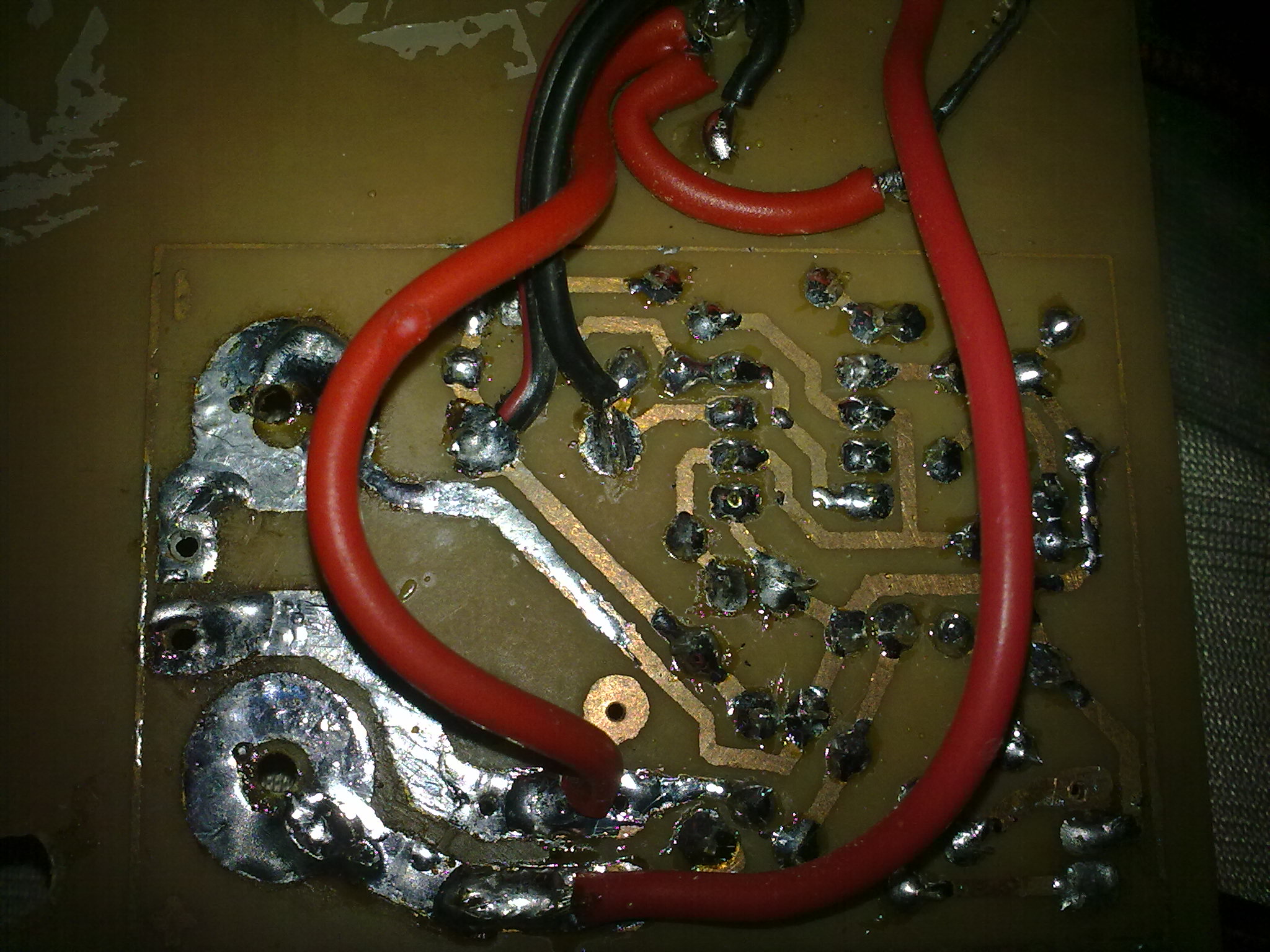

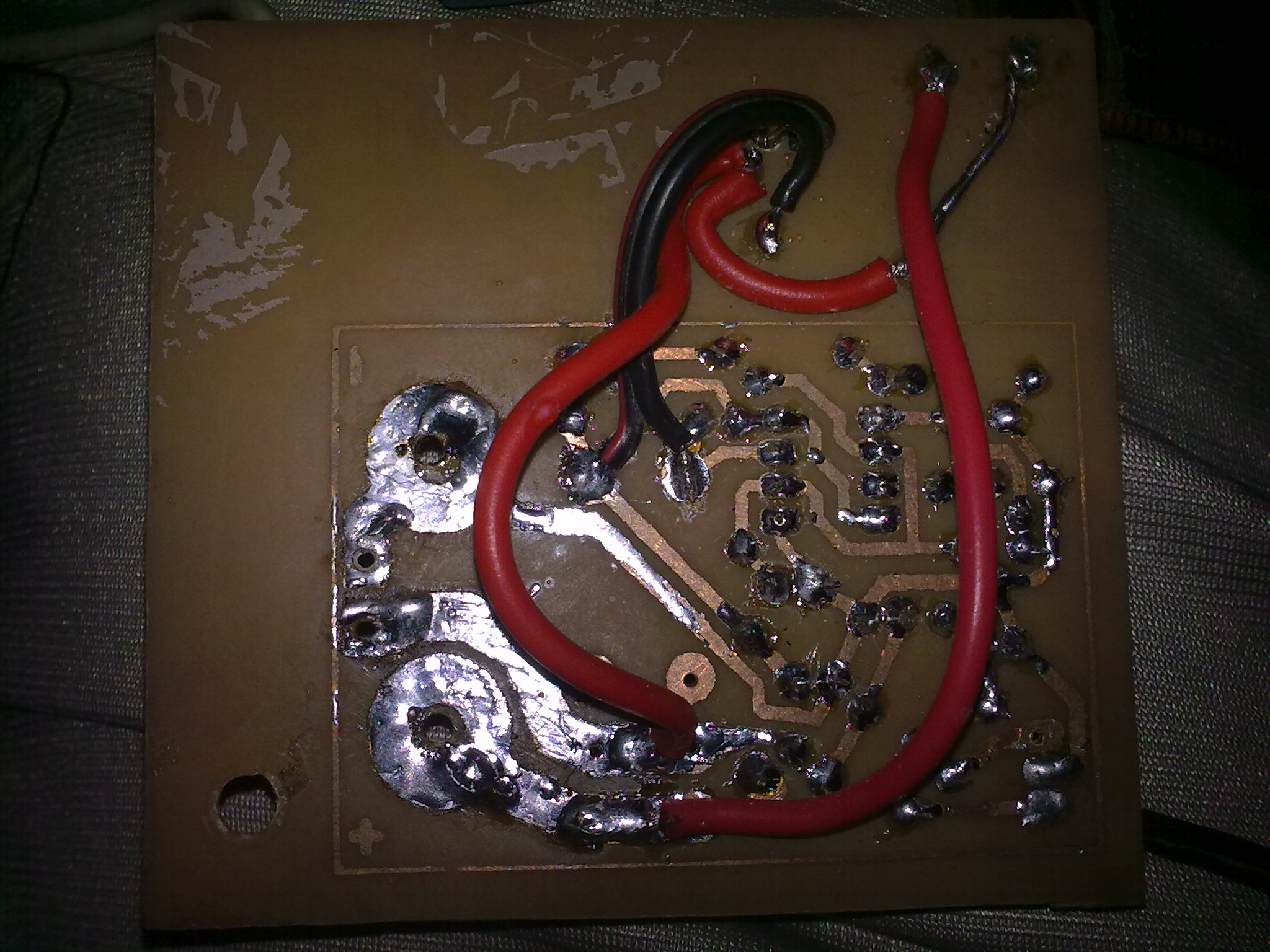

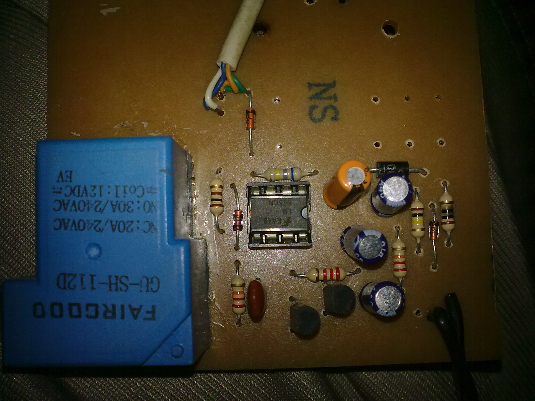

Hi Comasus,
Did you notice any difference in sound when you connected it to your amplifier?
I just wonder if this short circuit + speaker protect module will affect the sound of my amplifier...

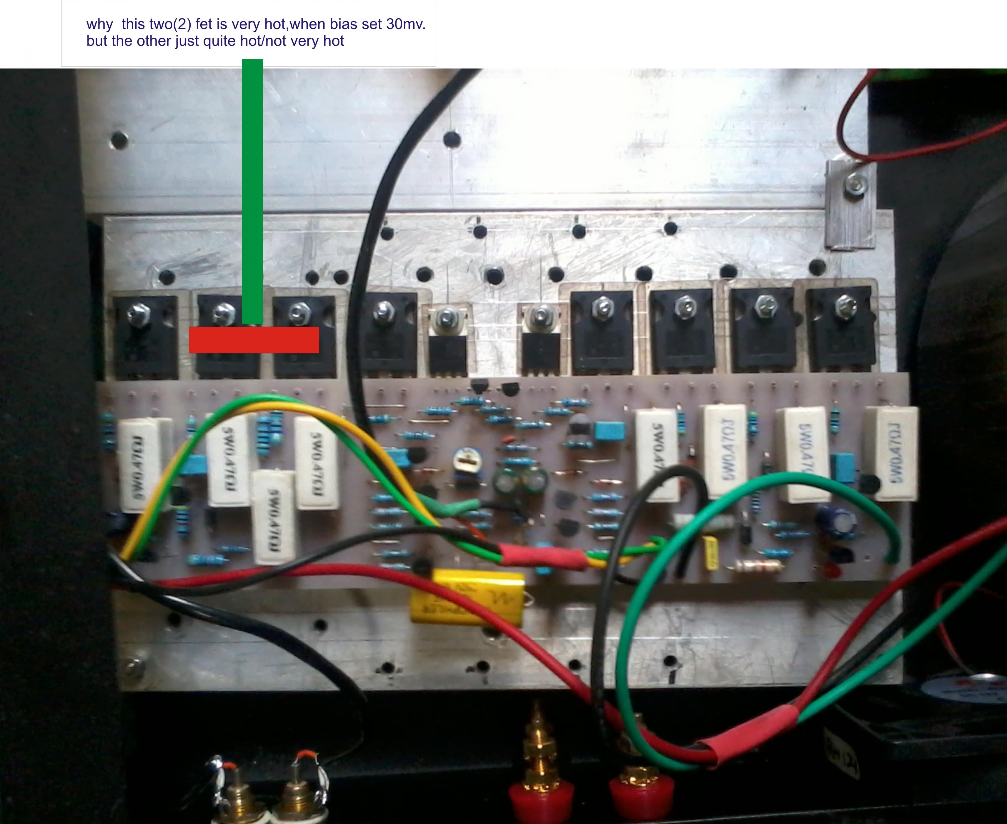

i didny have much time to read all the posts on this thread. what i just need is help on determining the bias voltage accross r20 and p1 or accross one of the 0.47ohm resistors which gives the 30ma bias current.
1-connect input gnd to power supply gnd. then check the dc offset.
2-bias adjustment, 10mv across 0.47 emitter resistor .
U= 0,01V
R= 0,47Ohm
I=U/R= 0,01/0,47= 0,021 (2765957...) A =21mA
For 30mA in 0,47Ohm by mr.Ohm it would be
U= R x I = 0,47 (Ohm) x 0,03(A) = 0,0141V = 14,1mV
Come one,if i know that than it can not be more coplexed than second year of hi-school -why it is so difficult to calculate-not just for you but for many teenagers today? Freaken computers will make a robots from us...
Thanks pipo but I have observed that we have two figures, 14.1mv and 10mv. So which is which here?
And also I have a 44-0-44 toroid transformer in ma possession and I want to use it on the hv23. The dc voltage is lower than the specified 75-0-75 in the hv23. Now the current is what I don't know about. All there is is that two 1mm thick wires were wound as a pair for the secondary. Need help on this as well.
