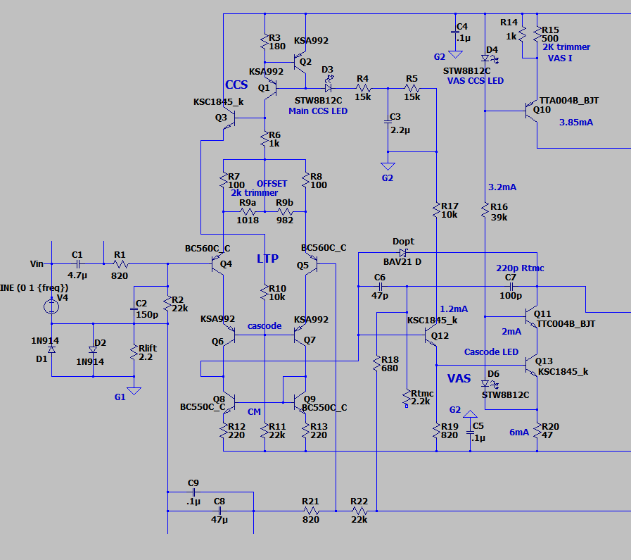

Take your time, the R26 D7 is not included correctly, think again to fix it.The design is now sufficiently stable....
If D7 is just a diode, then it is better to install a zener diode instead of R26 to fix the bases of the transistors in the diff stage.
The best solution would be to separate the stabilizing circuits for the 1st and 2nd stages of the voltage amplifier, because they have different conductivity: Q14/19/28/29 & Q22/25
Their unpleasant role is to limit the gain of the voltage amplifier, which on the one hand improves linearity but at the same time reduces the gain of the open loop. With the correct modes and correct correction, their presence in the amplifier is not required, because they impair control of the output power transistors.What is the role of R36 and R29 ?
Its superb, also use schematic in first post. When somethings new it looks strange but a couple ticks later its normal.Take your time, the R26 D7 is not included correctly, think again to fix it.

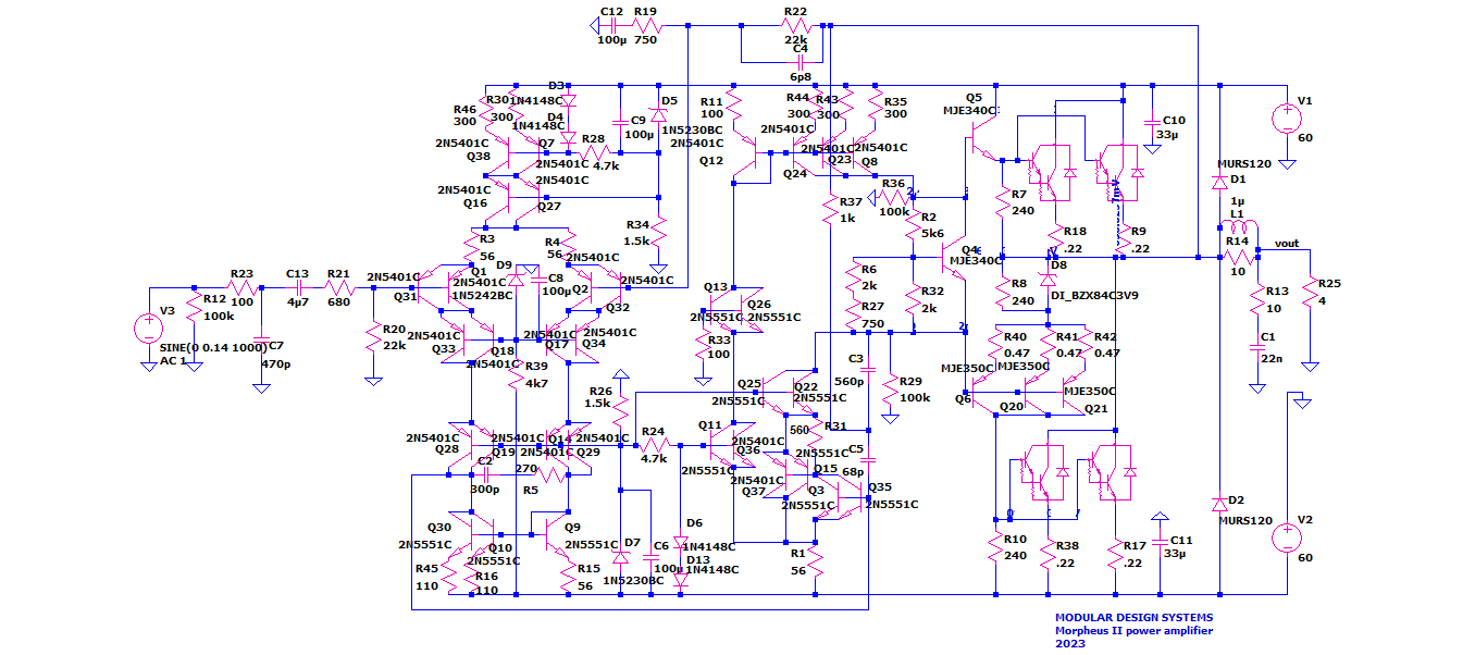

With that many semi's the matching and differences would "swamp" any ultra low THD performance. Realistically , with fewer devices .... noise,
heat and stability/reliability will be improved. I can get .5ppm/20Khz 100w with just 14 devices. SMD allows for better matching , less devices = less heat
and the possibility someone will build it. Even as Sanken darlington devices are available ,much higher Pd standard outputs rule , EF3's are (better).
Diode CCS is even inferior to a red led CCS. 2Q with decoupling is 10X better .....
A Zener for the cascode reference is "sucky" ... better to derive that reference from the back end of the main LTP CCS (no ground reference).
parallel'ed devices offer limited (or negative returns). 5 SMD devices +2 leds would outperform that CCS/LTP/CM combo. (Way better PSRR).

I'm looking at the diagram post #51
See, through D7 and C6, interference along the negative power wire penetrates directly to the base of transistors Q14,19,28,29 where they are amplified by this cascade and then mixed with the main signal.

I don't mean to be too critical , but there are too many inconsistencies to cover (I ran the ASC). Simplified ,it goes (2 diode CCS/cascode/LTP/cascode/cascode/CM). separate reference for each. Zeners dissipate 35ma each and the VAS has a "shaky" current reference.It is unlikely that errors in topology will ever become a normal amplifier.
I won't mention the OPS !!! PS- Darlingtons nearly match Hfe of a typical EF3 , that is why they use them !
Simple is better (below). about the same deal , but with ONE reference for cascode/ltp and VAS (Q1-3) .... 13 devices-no diodes-no zeners.

- Morpheus ultra low THD
