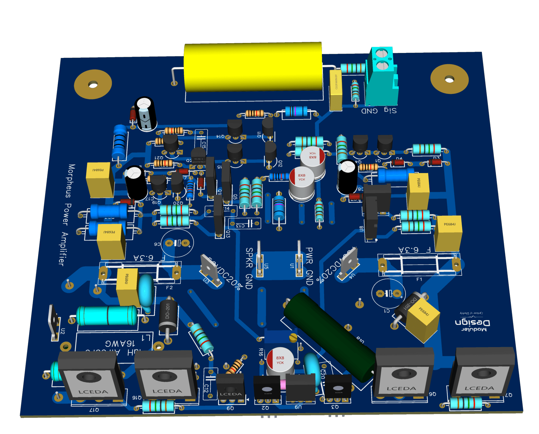

Ultra low THD is usually a very exciting area as most designers balance between zeros and oscillation, for some of these amplifiers all it takes is a sneeze from either the listener or the playback to set it off, even the weather can set it off, once you power it on, it whispers into your ear 'say somethn', hopefully morpheus will play nice

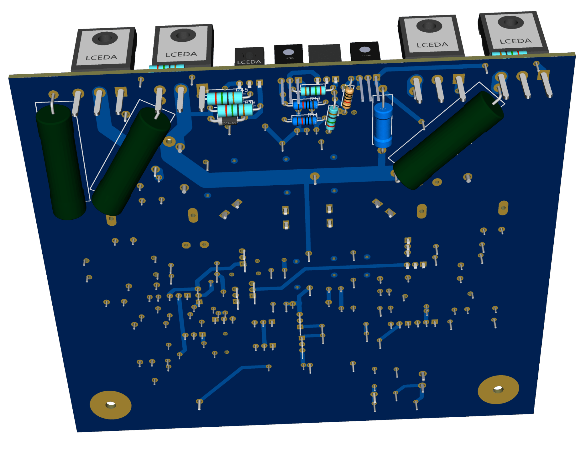

Morpheus Vs Orchestra , you choose 143.76mm*132.08mm, use own BOM (files provided for non commercial purposes for researchers, curious onlookers, audiophiles and diyers)
Bias @130mA
https://www.pcbway.com/project/shareproject/Morpheus_audio_power_amplifier_61fe3f69.html
Bias @130mA
at least 100watts 150 volts, depending on taste the other ultra low THD approach is here https://www.pcbway.com/project/shareproject/ORCHESTRA_POWER_AMPLIFIER_fce54e63.html

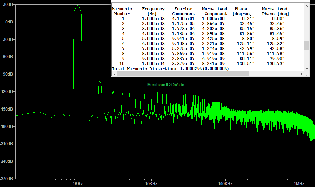

I agree.The simulated 1W/4R THD is useless. The noise contribution will be 1000 times of the THD. Also, any 0.0000x simulation that is not confirmed by measurements on a real amp is also useless.
The width of the peak depends on the window function and how many cycles fit in the FFT input buffer, nothing to do with the signal.
If you use many more signal cycles per FFT, and more bins in the FFT, you'll get much narrower peaks. Here's a great resource about the subtleties of the FFT (there are many): https://holometer.fnal.gov/GH_FFT.pdf
Don't read too much into the noise floor. The noise floor in an FFT is proportional to the FFT bin width. Increase the FFT length (-> smaller bins) and watch the noise floor drop.

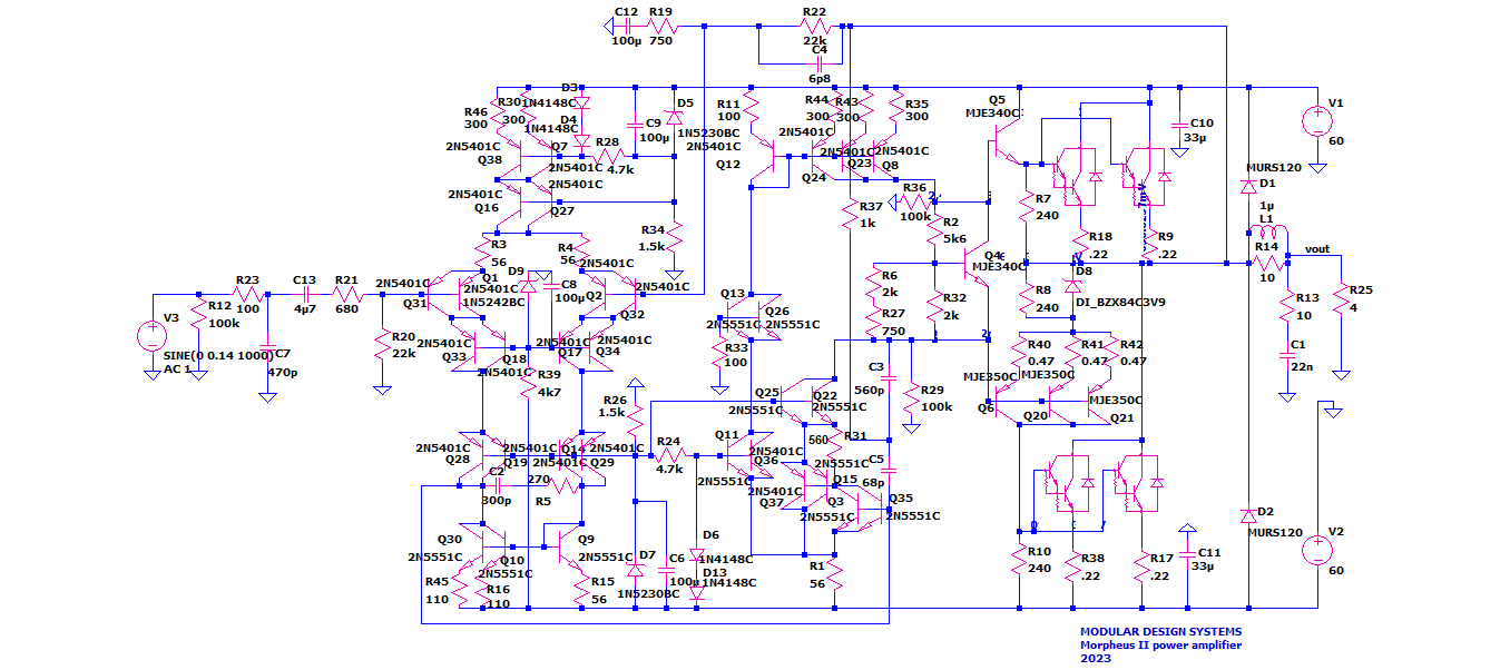

The simulation does show that the amp is not fundamentally broken ... assuming that it's able to produce a 20 Hz to 20 kHz sine wave into a 4-8 Ω load and has reasonable slew rate in simulation that is. I wouldn't pop open the champagne just yet, but it seems worthwhile to prototype the amp.
I'm not surprised that doubling up on the devices degrades performance. Usually a lower current density in a BJT results in worse performance.
How much loop gain does this amp have at DC and at 20 kHz?
