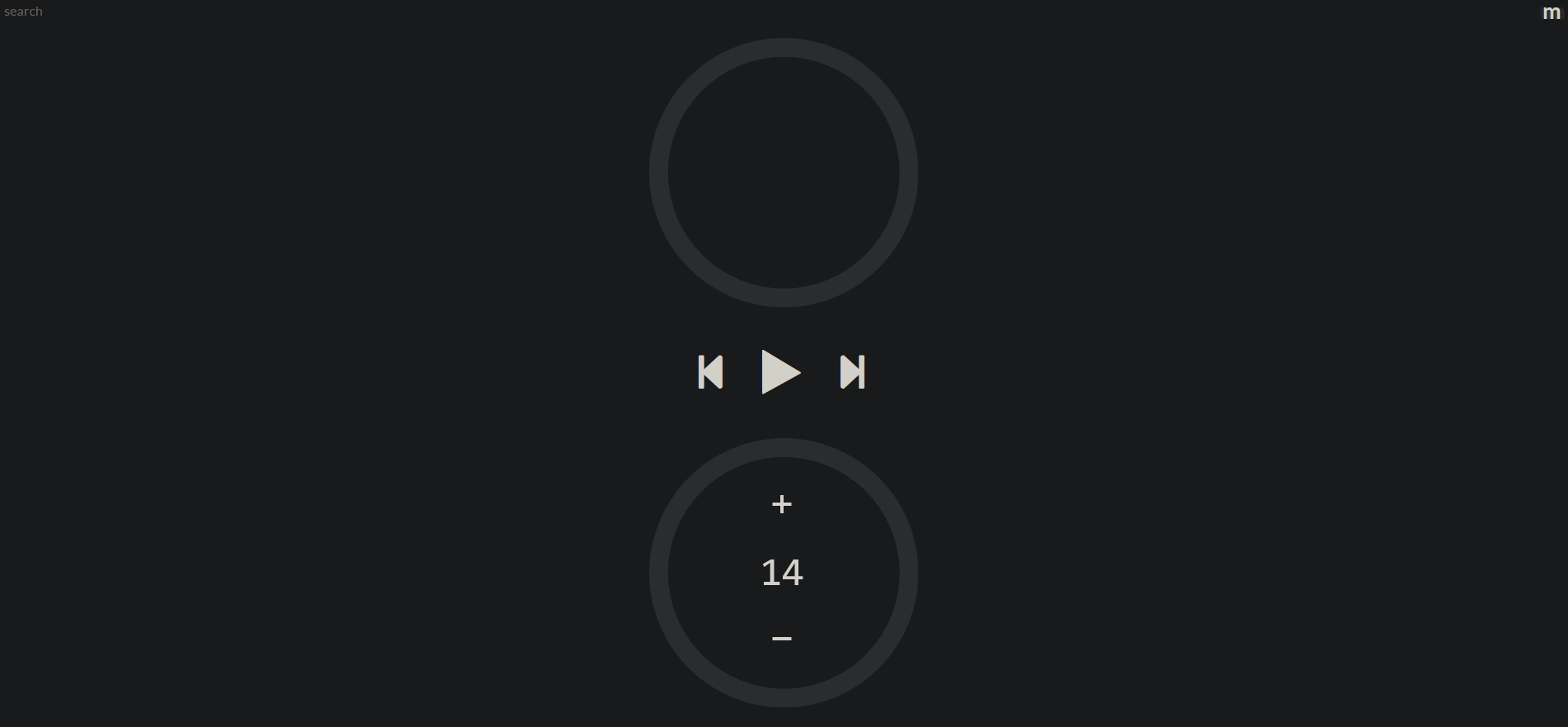

I've been using Moode for a while now, mostly playing radio streams. But it stops playing after a while stop. When I go to the browser I see the screen below.
The only way to get it back running is to reboot it. I've added the startup log. Any ideas what I can do to prevent that it stops playing?

- if using local display, is there a minimum RPi specs? I tried on my RPi 3B+ and it's struggling alot.
- Is using file album art (example: folder.jpg) less stain on these RPis
I've used local display on older 3B and no issues whatsoever. Maybe there is something else going on in your system that is causing a performance issue?
