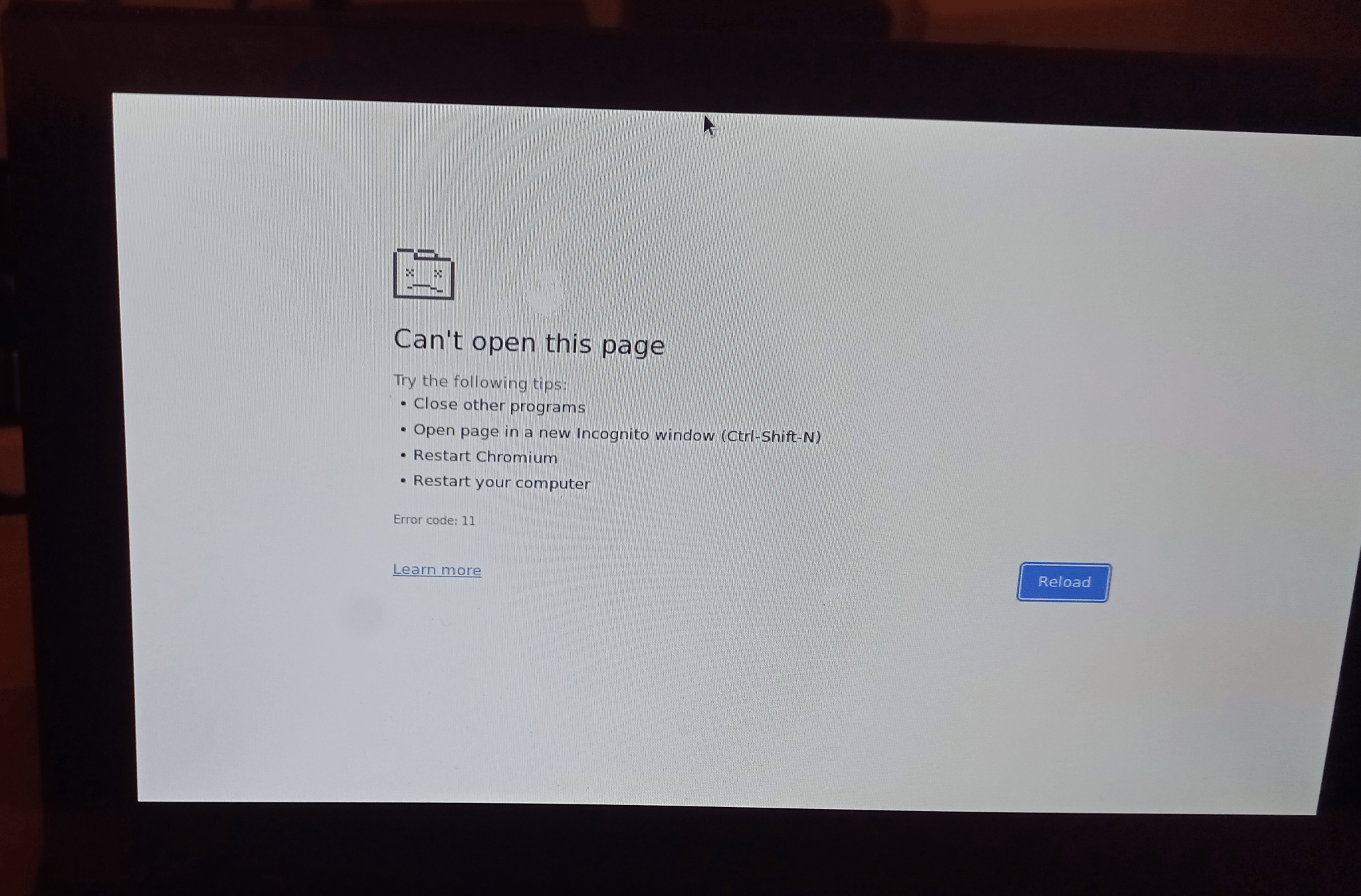

none can help with this?Suddenly my extrenal HDMI touch screen doesn't show the moode enviroment. Does anyone some solution please?
Hi all,
Looking at the screenshot it looks like a software problem (it is a Chrome message) so logical and phisical connections are ok (did you see on the screen all the raspberry boot procedure messages before that white screen?)
Do you have created the microSD with the "raspberry imager", as per the security procedure?
It "YES" please go to the moode forum and open a thread with your issue, because a deeper analisys is needed.

Very likely there would be some error detail in the chrome/chromium log, accessed e.g. via ssh (does moode have ssh enabled?) Details for enabling e.g. https://www.makeuseof.com/find-erro...how-to-enable-chrome-39-s-error-logs-on-linux (again there may be so moode-specific issues like RO filesystem etc.)

since some release moOde has introduced the Raspberry security procedure(for improved security the OS image does not contain the userid pi, SSH service, WiFi SSID or Access Point password), for a correct setup of the system you have to use the raspberry imager to prepare the microSD: the instructions are reported at the following link:
set up procedure
Would you please be so kind to follow that (if you did not yet) and report the results?
Best regards and thanks,
Francesco
