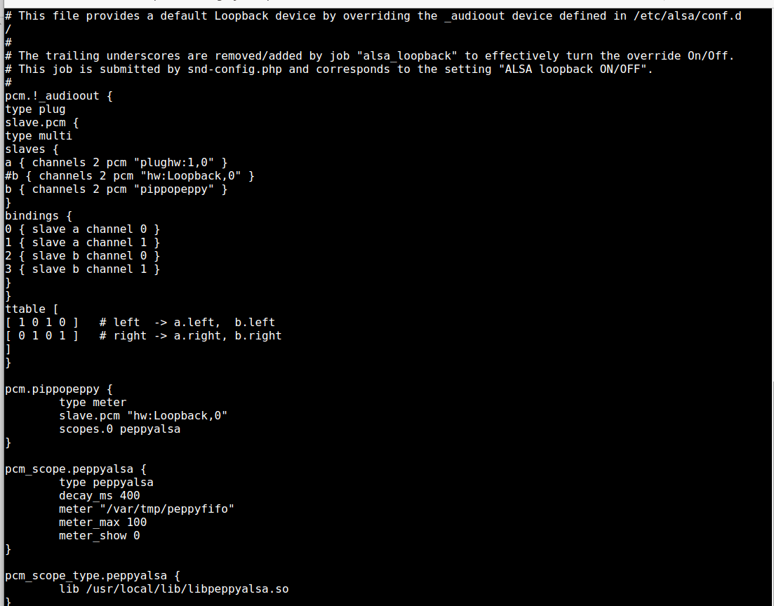

Trying to use a loopback with moode player. After a lot of trial and error I found that it works well with a USB dac I have here. But when I attempt to use it with headphones or HDMI I get the error 'Error opening also device _audioout snd_pcm_hw_params_set_buffer_time_near() failed : Illegal parameters. Any guidance would be appreciated.
_sndaloop.conf looks like this.
I see this:
(1) Loopback is only supported in Default (plughw) mode.
(2) Loopback requires a sample rate greater than 44.1K for Pi HDMI or Headphone outputs. This requirement does not apply if Multiroom Sender is ON.
How would I use this information. I assume I need to set this sample rate. Where would I configure this.
TimCurtis,
Im playing mp3s. When you say that loopback requires a sample rate greater than 44.1k does that mean that my mp3s need to be sampled at a higher rate when I generated them for the loopback to work on 44.1K or HDMI.
Resampling can be done on the fly by MPD.
Menu, Configure, MPD
Enable SoX resampling and set the sample rate to 48 as a test.
