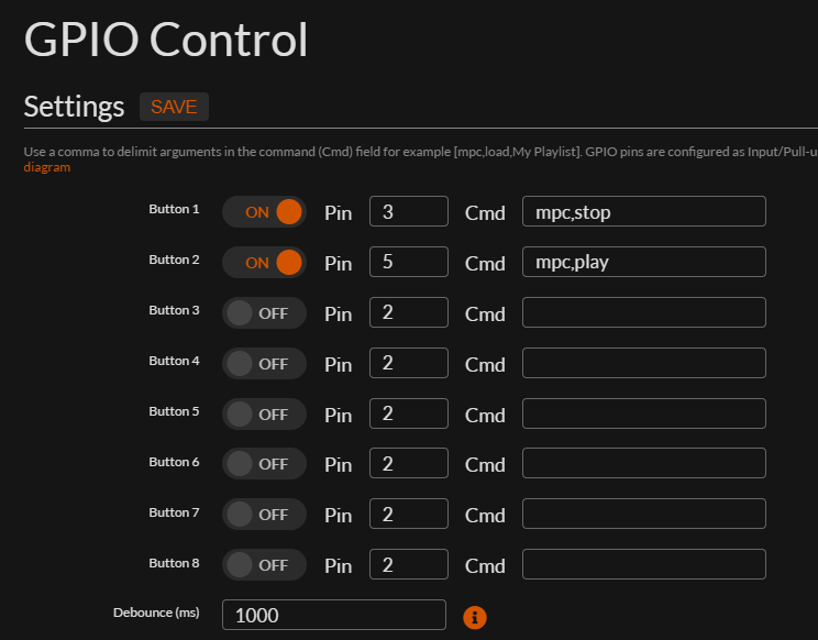

just started with Moode, and really wanted to use the GPIO / BCM to control my audio. I connected a wire between pin 3 or 5 and the ground. But nothing happens. Any ideas on how this should work?

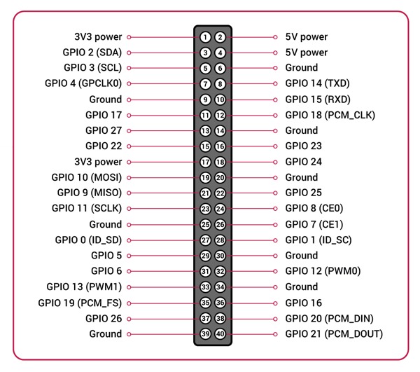

Hi walliesss,
Typically each GPIO pin (which does not correspond to the pin numbering of the connector) can have its own starting state.
The GPIO pins have an internal pull-up/pull-down resistor.
Remember never to connect 5V to the GPIO pins, only 3.3V or ground.
Connection of a GPIO to a voltage higher than 3.3V will likely destroy the GPIO block within the SbC.
The button should be wired between the GPIO pin and opposite voltage as the default pull. The plugin will detect any change on the GPIO pin.
Example: If using GPIO pin 17, the button should be wired between the pin and 3.3V (high) because the default pull is low for GPIO pin 17.
In my case I have tried to use the GPIO17, GPIO24 and GPIO27 which correspond respectively to the connector pins 7, 18 and 13.
In these case, therefore, we are talking about a LOW start state for all our pins.
Francesco

Hi walliesss,
Please, furthermore, note that on the moode GPIO configuration must be reporter the GPIO number (not the connector pin number).
Francesco

Thank you ! That’s very helpful.
And the commands should be something like mpc,start and mpc,play ?
Correct

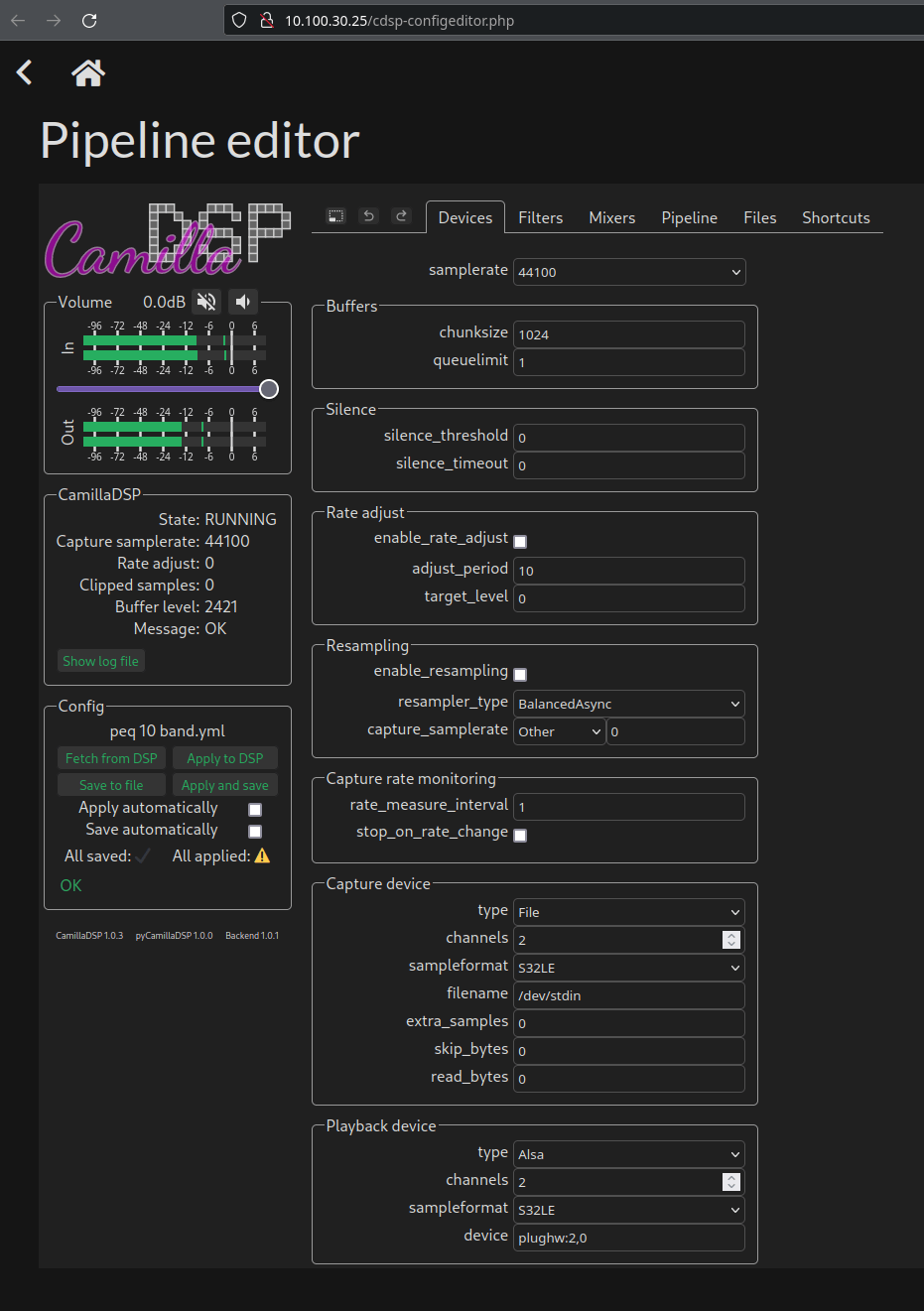

I flashed moOde 8.3.5 into a card last night and although it is functional I am having two problems:
- I cannot seem to grasp the format of .mpdignore files and the software imports everything in an external usb drive (when I would want it to import a single folder). I have visited the link provided by TimCurtis to the MPD page and also read that it could be a permissions problem so I chmodded the text file, but still get everything after a reboot/rebuild.
- I cannot seem to access CamillaGUI. After I turn it on in the CamillaDSP configuration and click on the editor link I get a page with the Pipeline Editor header but no content. Source appears to point to "/camilladsp/gui/index.html" but I do not see a camilladsp folder in "/var/www".

Issue 1 has been resolved: I was copying the folder names in the 'folder_name' format and getting rid of the apostrophes did the trick.
Issue 2 persists.

#2 is a bug :-0
Run the command below in an SSH terminal and you should be all set.
I'll add to the TODO list for upcoming bugfix release.

Code:
sudo sed -i s'/onchange=\\\"$(/onchange=\\\"autoClick(/' /var/www/cdsp-config.php
