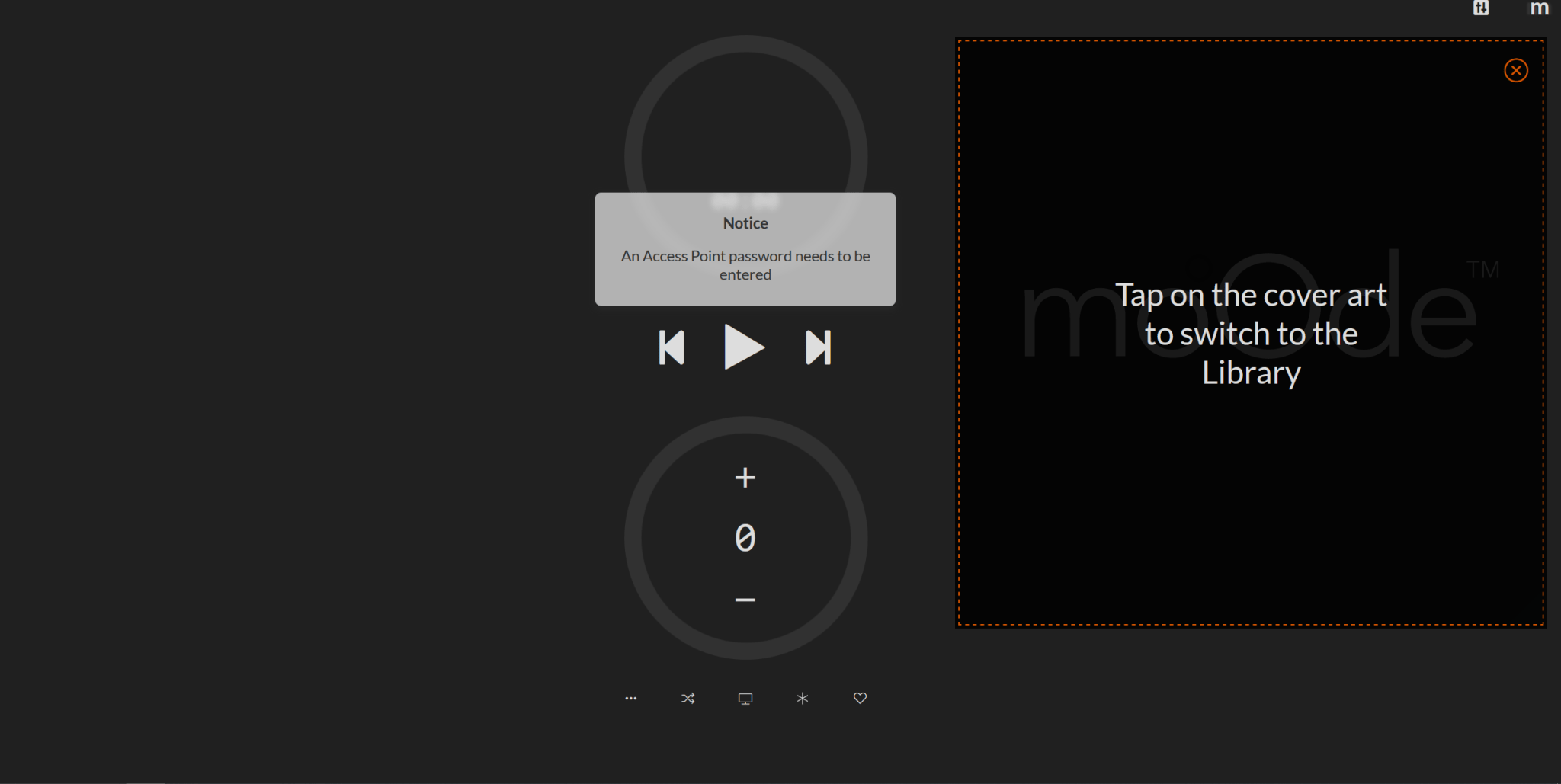

Hi All,
Hoping for some help please! Have searched online but no results:
Accessing the GUI (latest MoOde) by both Chrome, Safari and a screen connected on HDMI, the upper left menu only has "search". The library etc have gone. The current Queue still plays and the USB library is still accessible via the "*" wild card button so I know it is still connected. Have tried refreshing the browser window, refreshing web GUI from MoOde settings, regenerating music database etc and restarting streamer (Pi4 compute). No avail.
Everything seems to be working but the GUI has lost the menu somehow.
