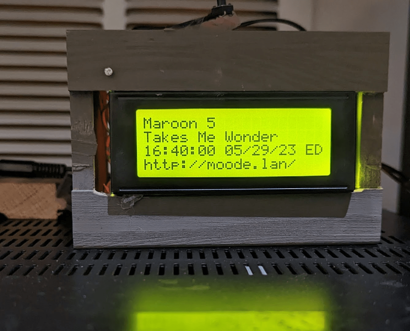

for those interested, here is an LCD updater script in python for HD44780 2004 LCD 20x4 2004A
Code:
#===============LCD_UPDATER / lcdupdater====================
#STEPS:
# 1) download: https://github.com/the-raspberry-pi-guy/lcd
# 2) copy /drivers to /var/local/www/commandw
# 3) setup i2c (test withi2cdetect -y 1 ) (follow instructions or run the shell in lcd)
# 4) test the lcd independently (script is for a 20 X 4 HD44780 2004 LCD 20x4 2004A )
#https://github.com/the-raspberry-pi-guy/lcd
import drivers
import subprocess
from datetime import datetime
import time
display = drivers.Lcd()
#fixed fields
nowstr=time.strftime('%X %x %Z')
hostname="http://moode.lan/"
#Load the values from the currentsong file
songattr={}
with open("/var/local/www/currentsong.txt") as file1:
for line in file1:
name, var = line.partition("=")[::2]
songattr[name.strip()] = var.strip()
display.lcd_display_string(songattr["artist"], 1)
display.lcd_display_string(songattr["title"], 2)
display.lcd_display_string(nowstr, 3)
display.lcd_display_string(hostname, 4)
