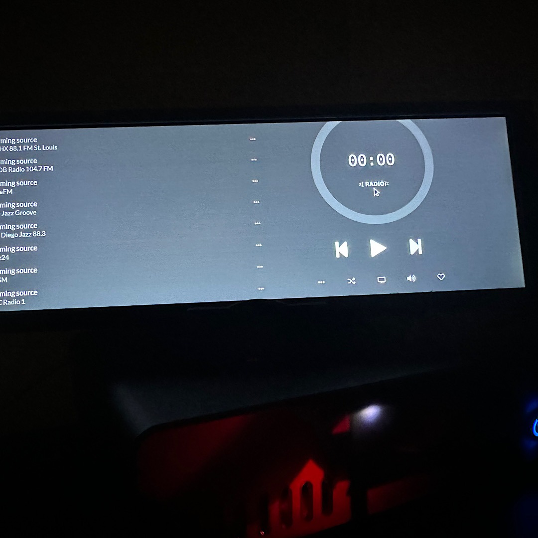

I installed latest moodeaudio on Raspberry pi 4 and connected to display 8 inch. but the result is like on the picturea and the touchscreen not working. Anyone can help me to solve this problem?
