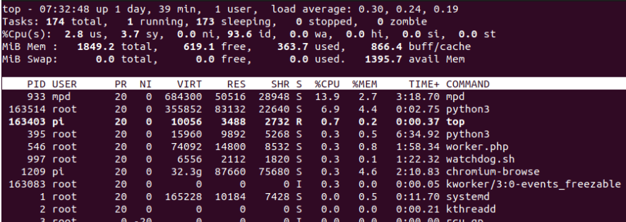

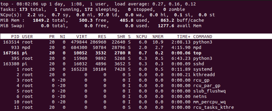

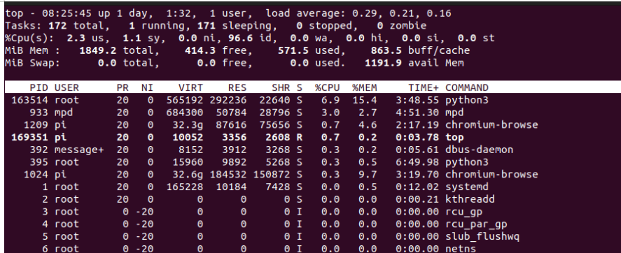

It could help in the troubleshooting if you try the following command at the begin of the cycle (first minute) in the middle (25th minute) and at the end (before it stops = 48th minute).
The command is: top.
Best regards,
Francesco
Hi Francesco,
thank you very much for yout help!
On the results, I can´t find the issue:
Begin:
Middle:
short time bevore break
