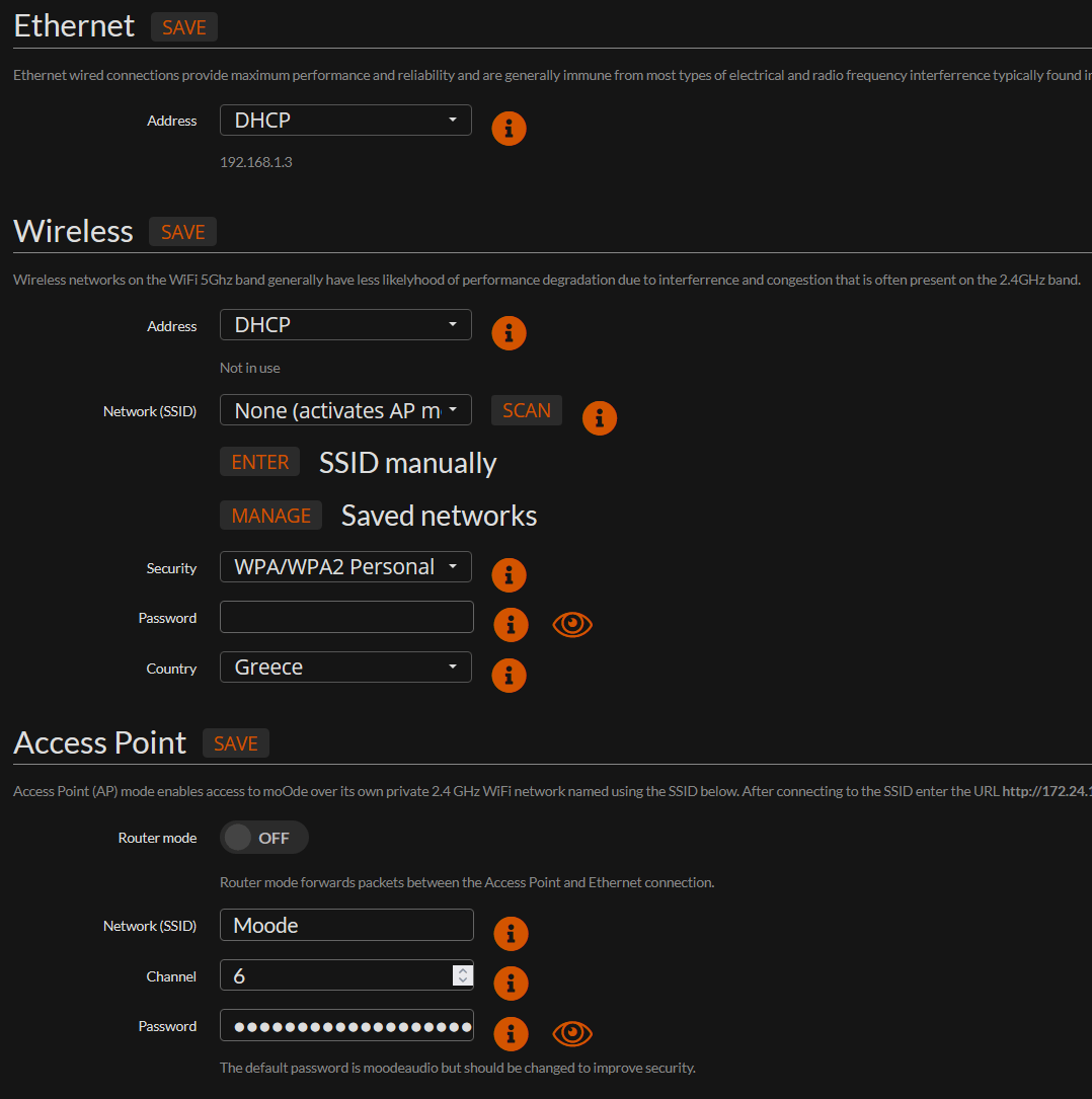

@TimCurtis, here are the data
  • moOde version 8.2.5 2023-01-20
  • Pi model Raspberry Pi 3 Model B+
  • Network config check below
  • Number of tracks in collection 405000 tracks
Looks Ok although if you are not going to be connecting to SMB shares I'd prolly turn off SMB file sharing.
The way to troubleshoot "empty library" is to regenerate the Music database from scratch while monitoring the MPD log for errors.
