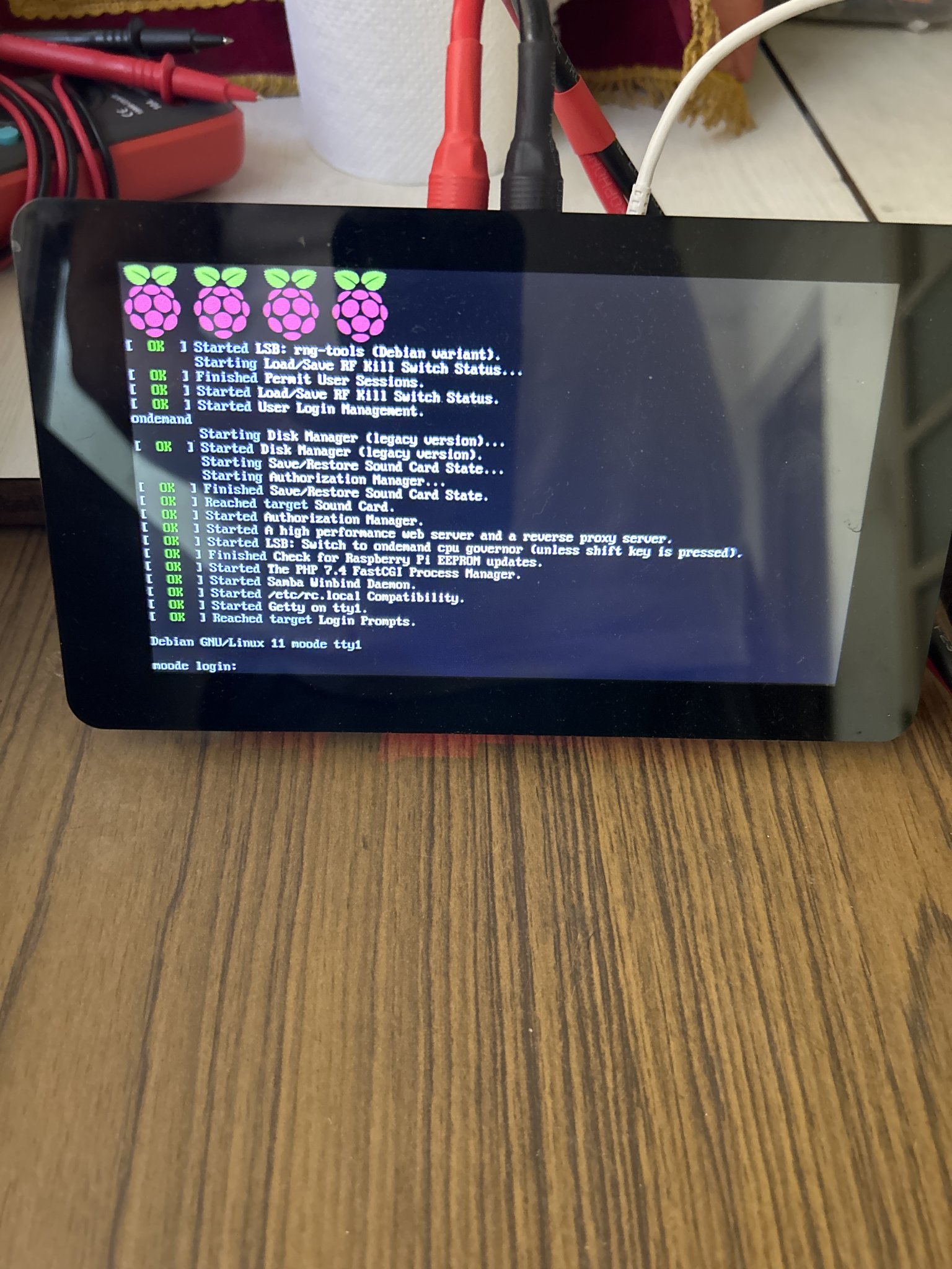

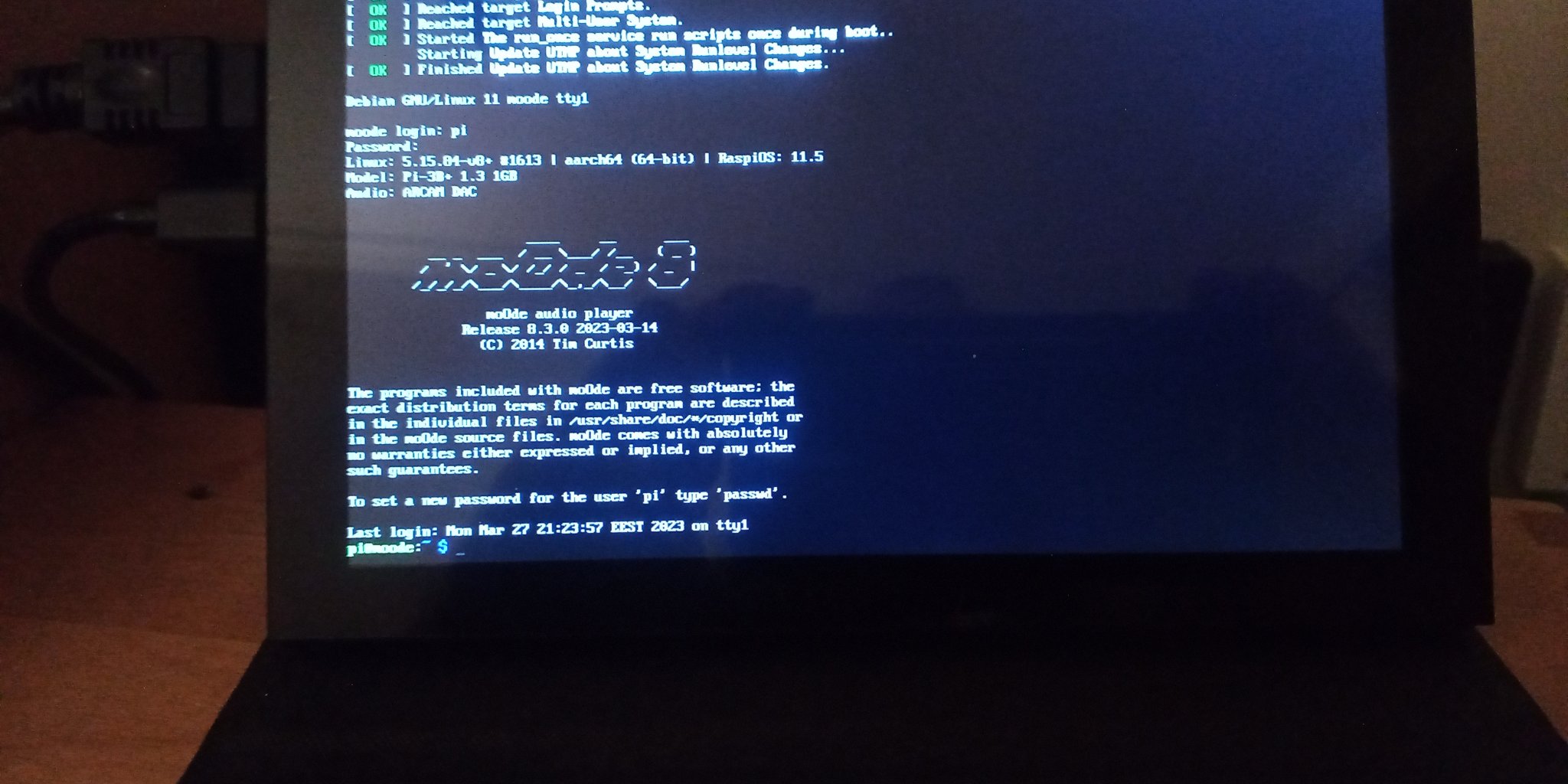

I am not able to see moode UI on a local screen after updating. Any suggestion please?
Hi Guys,
The local Display is not working, I have re-installed Moode on a new SD card.
I have re-activated local display and rebooted the system -> no local display just stays on the verbose.
I even used the use local display restart button (via phone), But still i do not see the Playback display.
If support for Waveshare 7" DSI display removed, than please let me now since i have used this display so far on MOODE without any hickup till the previous release, i had shifted to different distro so as to be able to pla audio cd via the usb dvd rom...
this is quite frustrating if a known working display suddenly stops to show the local playback screen.
... The local Display is not working, I have re-installed Moode on a new SD card. ... This is quite frustrating if a known working display suddenly stops to show the local playback screen.
Since you are already on a new SD install, maybe try an older version (preferably the one you used before) - Two reasons: (1) there might be a step you have forgotten you need to do, and (2) just to verify everything works? I had a problem that turned out to be a poor cable connection, might have been bumped.
I am currently using a different distro, without issue and it can’t be a cable issue either as then I would not get the verbose screen and select language, set new password etc.
I will try an older version just to get back in Moode.
