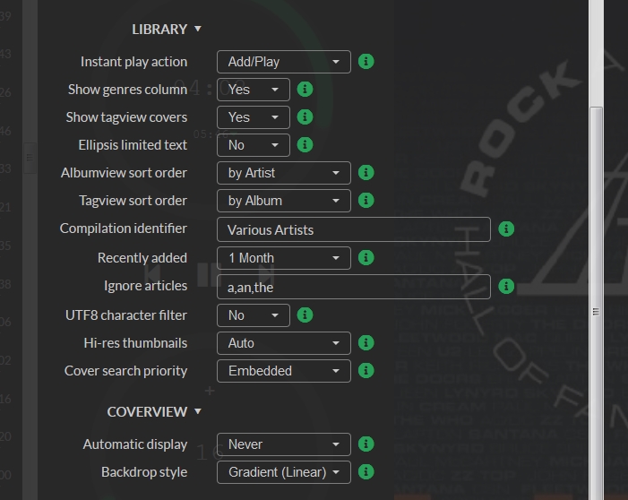

So I was really surprised to see the Compilation identifier in the Appearance settings of Moode. In my library I have hundreds of compilations (like concert recordings) with various Album Artists fields, so identifying them all and putting into this field is a rather tedious task. Obviously I do not want to tag all my compilations with the same tag, because it would make them a nightmare to navigate.
Is it possible to change this behavior? I think if we follow the fb2k approach then the Compilation identifier is not needed at all. And from my perspective this would make things more practical and intuitive.

The tagging strategy I mentioned is used by most moOde users and works perfectly to group all compilation albums under "Various Artists" or "Compilations" or "OTHER_STRING" in the Library.
I leave it up to you to search regarding this method. It's discussed on many audio forums.
Unfortunately, because there is no official ID3 standard tag to indicate that a track belongs to a compilation different approaches are taken by users and player software for example iTunes has its own proprietary tag for compilations.
If you like, zip up 2 of your compilation albums and email me a download link. I'll see if it might be possible to accommodate this particular compilation approach in the Library.

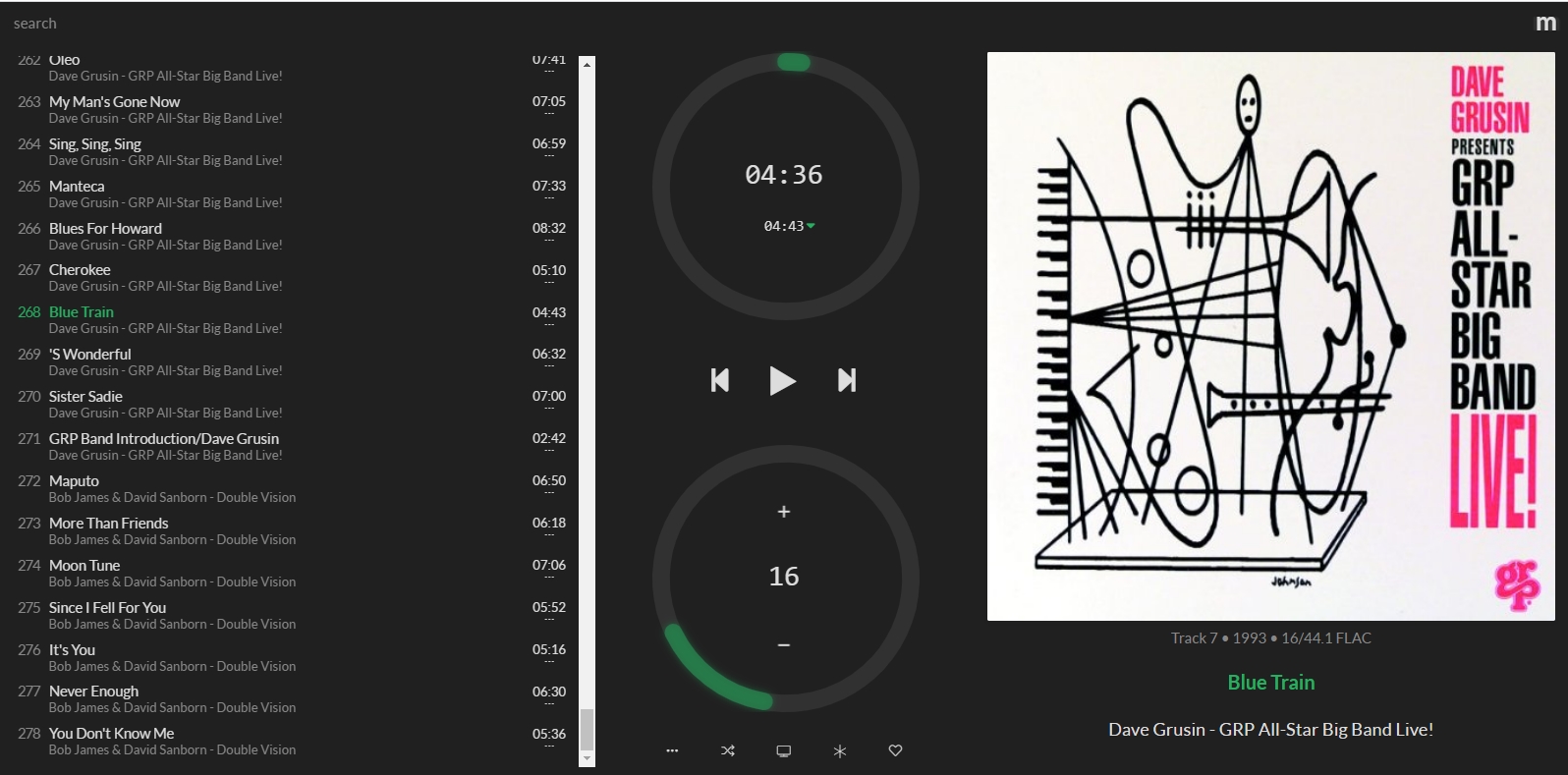

UI Configuration
First, as a brand new user, please let me apologize for my complete idiocy regarding my complete inability to set the UI page appearance how I want it. I swear I've clicked every pertinent button; all does nothing.
My Web Browser UI appears like this; (pic 1)

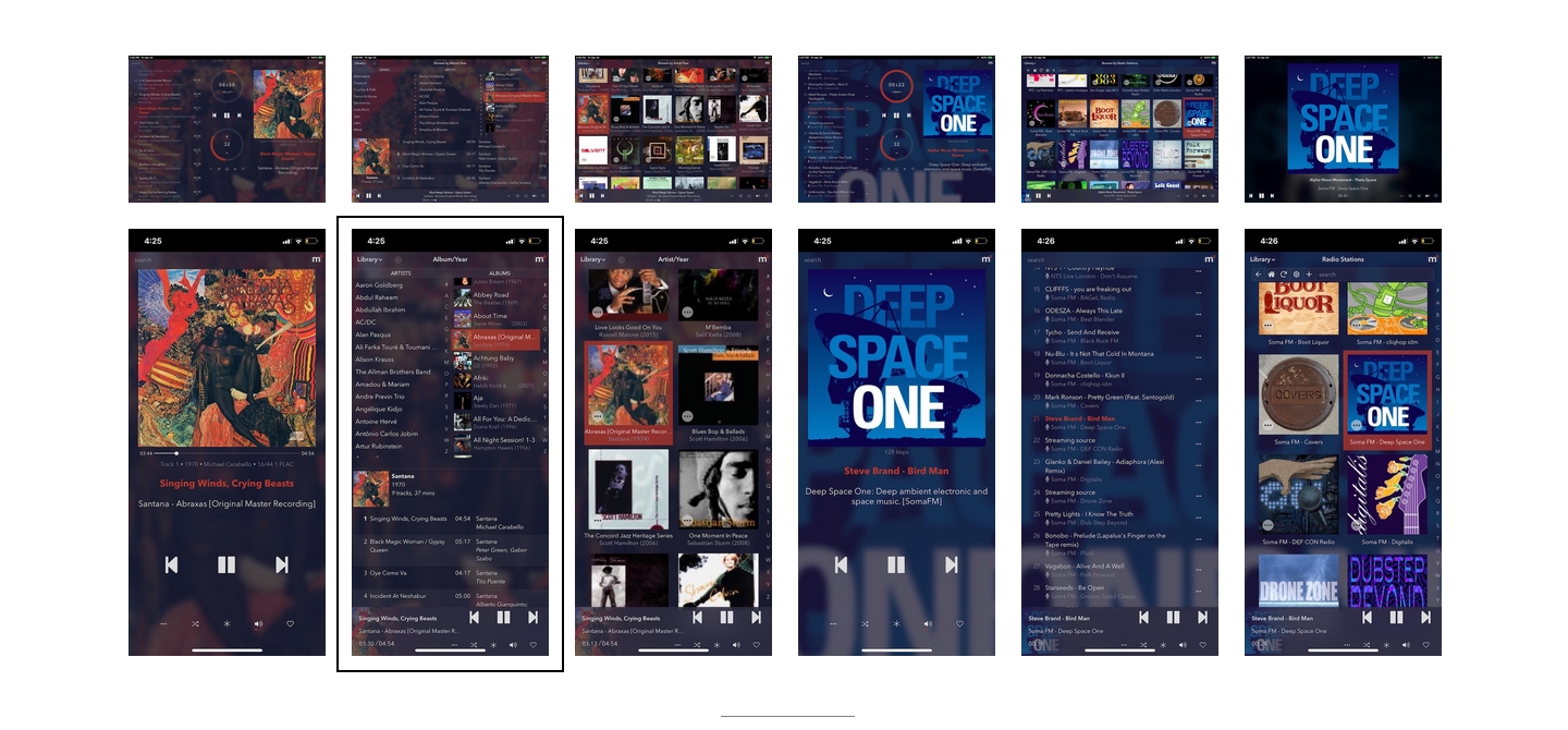

I see on the Moode website several display modes, I'd like the one I've highlighted; (pic 2) Seems no matter what options I select, I always end up with a straight columnar list of every song on the USB stick, versus something like "album covers".
Media on the stick is organized as a subfolder for each artist's album.
Can someone please help me with the correct settings? Could there be something wrong with my install? The only options that seem to respond are the background and highlight colors.
Really appreciate any help I can get on this.

Menu, Quick help
What a noob! Of course you click on the album picture to get to your Library. Thanks - I think I got it - I'll start sewing back in all those hairs now
