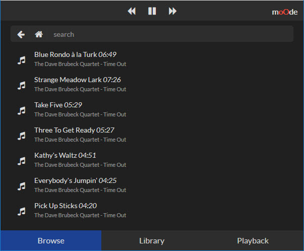

hi Tim and all,
on the BROWSE screen, there is no more line separator between artists(folders)
is it on purpose?
checked with FF and Chrome
Hiro
There aren't any line separators anywhere in NewUI 🙂
-Tim

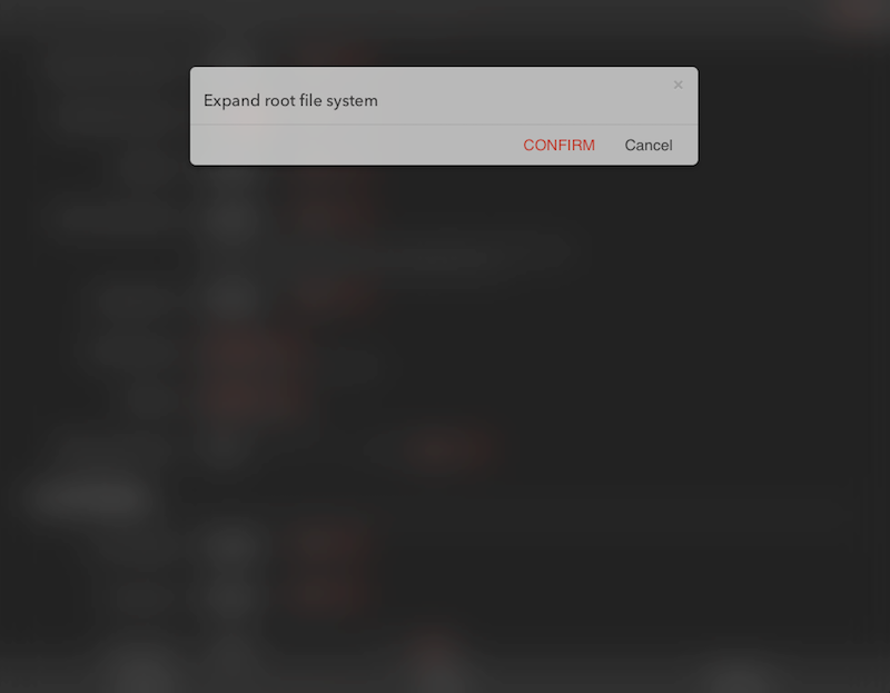

trying to expand the root partition.
Clicking EXPAND doesn't trigger anything.
am using 32G uSD with 3G occupied.
any suggestion?
You should see the confirmation popup after clicking Expand. After clicking Confirm, the message below should appear and then the system will automatically reboot.
FS expansion job submitted
Reboot initiated
-Tim

Hi Tim,
ok ... no lines anymore, but there are also no dots on the right side of "Browse"-tab. Not possible to call "Add", "Play" or "Clear/Play" anymore ???
At the moment I only can play music from "Library"-tab (Firefox & Chrome). In Safari (iPad) I see only "white pages" on all tabs, except "Configure"screens. MMI customize setting is all standard.
Not good ...
-Tim
