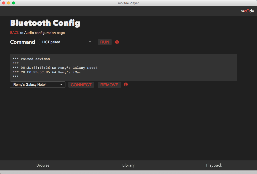

Hi Tim,
Just wanted to let you know that with version 4 bluetooth seems to work better. I managed to connect to my computer and my smart phone on the first try.
Remy

Edit: there's some sort of rendering problem on chromium browser....
Looks great on firefox 😉
