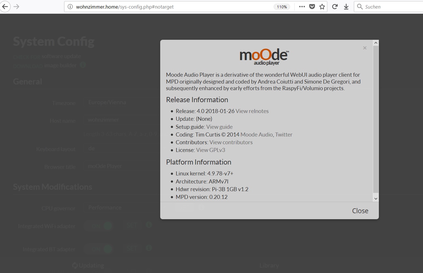

moOde release 4.0 is available at moodeaudio.org. The download includes moOde 4.0 Sources and a Build Recipe for making the custom Linux OS that runs moOde. An automated OS Image Builder is available in the Support section.
Great, many thanks, Tim!
I take it this is not an in-place upgrade from the Betas but will require a new build?
Richard

Hi Richard,
Yes, new build due to the nature of the changes between beta and prod.
-Tim

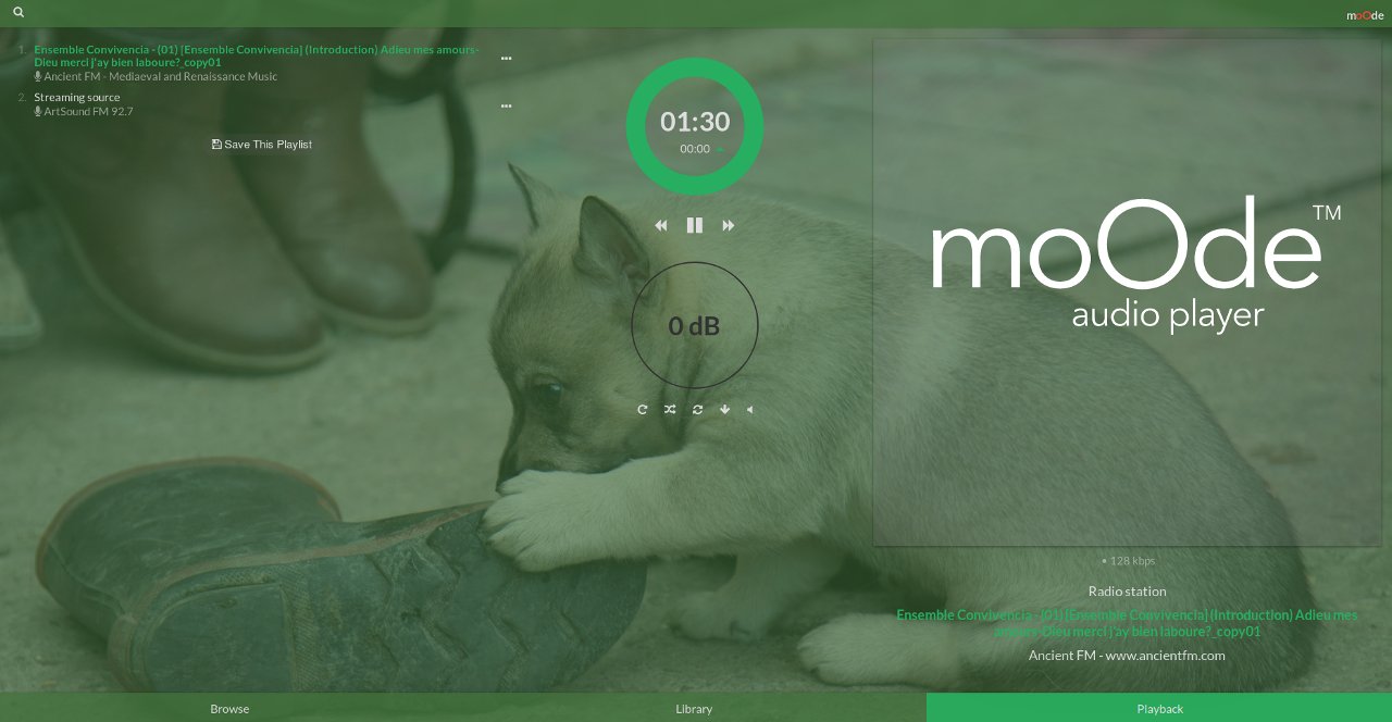

Tim..this new version is such a massive leap forward. !!
Not only has sq improved but the UI customisation options are just superb.!
Only problem I am having so far so far is images not showing for the stock radio streams.... am I missing a setting...?
Great how the 'add/play/etc' options now appear left instead of having to mouse/swipe right

Hi Bob,
Odd about the radio covers, theres no setting :-0 Email me /var/log/moode.log and I'll have a look.
Cred to @swizzle for the incredible UI
-Tim
