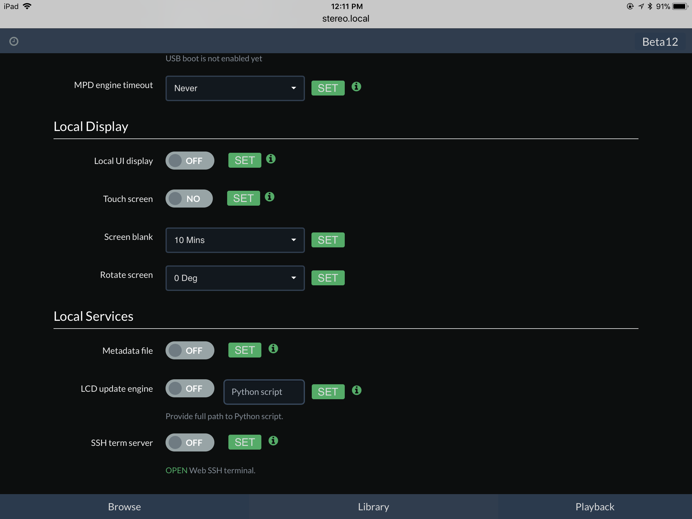

Hey all. I used HeeBoo's script to install 4.0 Beta 12. So far so good - going to moode.local works, I can stream music, SSH, etc.
The issue I'm having right now is with the display and getting Local UI to work. When the Pi boots up, it displays the usual startup stuff, says the Authorization Manager is enabled, and then the display output basically turns off. The display options in /boot/config.txt are correct, especially since I get that initial startup load screen.
localui.service is running:
$ systemctl status localui.service
● localui.service - Start Chromium Browser
Loaded: loaded (/lib/systemd/system/localui.service; enabled; vendor preset: enabled)
Active: active (running) since Sat 2018-01-27 16:44:23 EST; 13min ago
Main PID: 468 (xinit)
CGroup: /system.slice/localui.service
├─468 /usr/bin/xinit
└─469 /usr/lib/xorg/Xorg :0
Any ideas why the display turns off?

I've got it going into a 24" Samsung monitor with a DVI - HDMI cable, so in the boot config I'm setting:
hdmi_drive=1
hdmi_ignore_edid=0xa5000080
config_hdmi_boost=6
hdmi_force_hotplug=1
hdmi_group=2
hdmi_mode=27
But I've tried a 27" LG with HDMI - HDMI, and it acts the exact same way.
Hi @gchucky,
I test with Pi-3B and ASUS 24" HDMI monitor and no issues. I don't add anything to config.txt
-Tim

And all of that is configured. Again, here's what happens on boot:
* Visible on screen: standard Raspbian setup scroll data
* After initial setup, the screen blanks, and Moode Audio starts running (confirmed via SSH)
If I'm SSH'd in and do sudo reboot, the screen turns back on and shows the shutdown steps (e.g. Chrome shutdown). I added consoleblank=0 to /boot/cmdline.txt and raised config_hdmi_boost to 10, but that didn't do much. So it's really only when Moode is actually running that the screen is blank. Which is totally fine - but that means that the Local UI isn't working for me. Attached is a screenshot of the config. Am I missing something?
@TimCurtis, it's attached. Everything looks okay to me, but maybe not?
Nothing suspicious in the log related to the display but looks like all the ALSA outputs are on and only one should be on. You can either toggle one of the DSP features on/off in Audio config or run cmd: mpc enable only 1 from ssh.
20180128 140245 worker: MPD output 1 ALSA default (on)
20180128 140245 worker: MPD output 2 ALSA crossfeed (on)
20180128 140245 worker: MPD output 3 ALSA parametric eq (on)
20180128 140245 worker: MPD output 4 ALSA graphic eq (on)
If your display just turns off then possibly any manual edits to config.txt are causing breakage or the display may not be compatible.
You can also verify that in fact HDMI port is on by cmd: tvservice -s
-Tim
