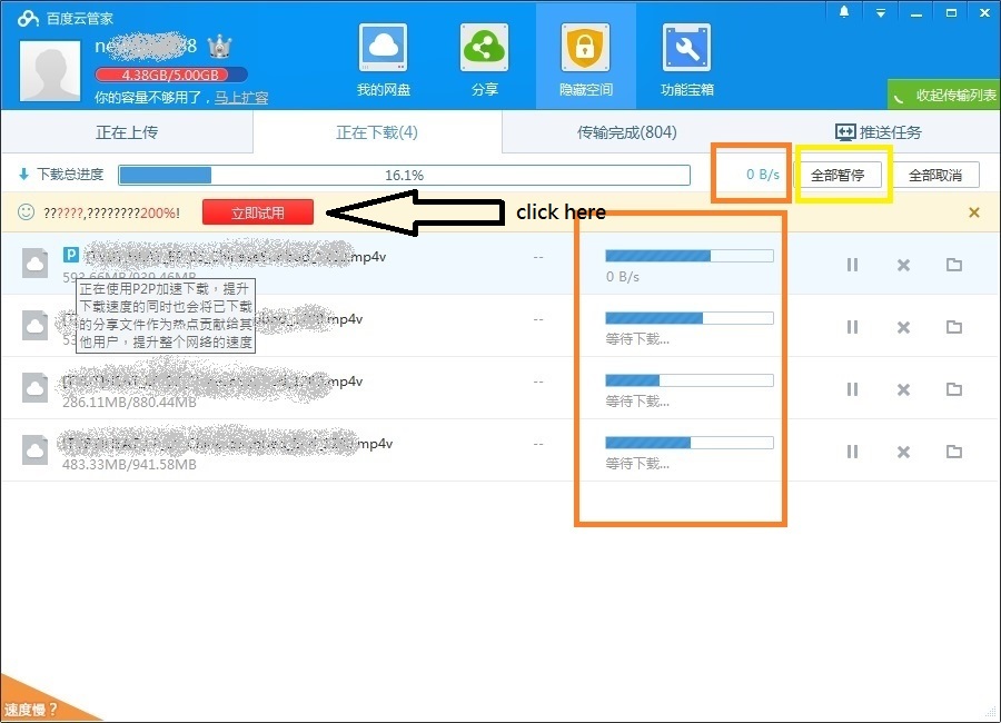

The taobao seller provides image files for moode, volumio, runeaudio, Dietpi, Tinycore with DSD128/PCM384 or SACD-ISO.
Image files can be download:
树莓派等ARM板播放软件_免费高速下载|百度网盘-分享无限制
You need to install Baidu Netdisk first.
http://sw.bos.baidu.com/sw-search-sp/software/57cf90c2afd18/BaiduNetdisk_5.7.2.3.exe
Baidu account has to use Chinese mobile phone for registration now. I am a registered user many years ago. But you can try to get QQ account first using English GUI, and then use the QQ account to login Baidu netdisk.
Download speed is very slow for non-paying members, but you can click on the icon of the photo, you can temporarily get a faster download speed, and then click again the next day.

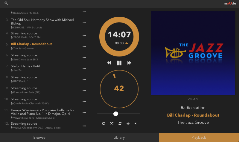

I'm finishing off some very nice UX improvements for the Pi 7" Touch including brightness control, auto-fit aspect ratio and an easy to use volume slider that controls the volume knob. The volume knob is read-only in this case.
Also, the volume knob code has been enhanced to include bounds checking that ensures that only input (click, touch) within the knob circle is accepted 🙂
Its a bit more testing and thus the GA release may slip a bit into 1st week of Feb.
-Tim

Sounds great... Really looking forward to the final release 🙂
