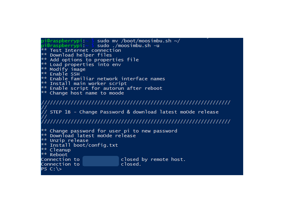

Hi
I am stuck on step #8, Heebo word doc. I boot up the pi and get the following prompt:
Raspian GNU/Linux 9 raspberrypi tty1
raspberrypi login:
What do I do from here? I also need to edit the \boot\config.txt to
add:
dtoverlay=pi3-disable-wifi
dtoverlay=pi3-disable-bt
How can I do that? I will first use ethernet cable to do the build, then
using an edimax usb wifi adapter so I want to disable the onboard wifi.
I see the guide says to type FING to get ipaddress of the Pi but it's asking for
log in information.

Does this mean it is building?
After build is complete, what does the Pi show on screen?
How do you know when build is completed?
Need to reboot once?
I switch monitor back to the Pi and I get a blank screen.
Is this normal? I see the ethernet light still flashing on the Pi.

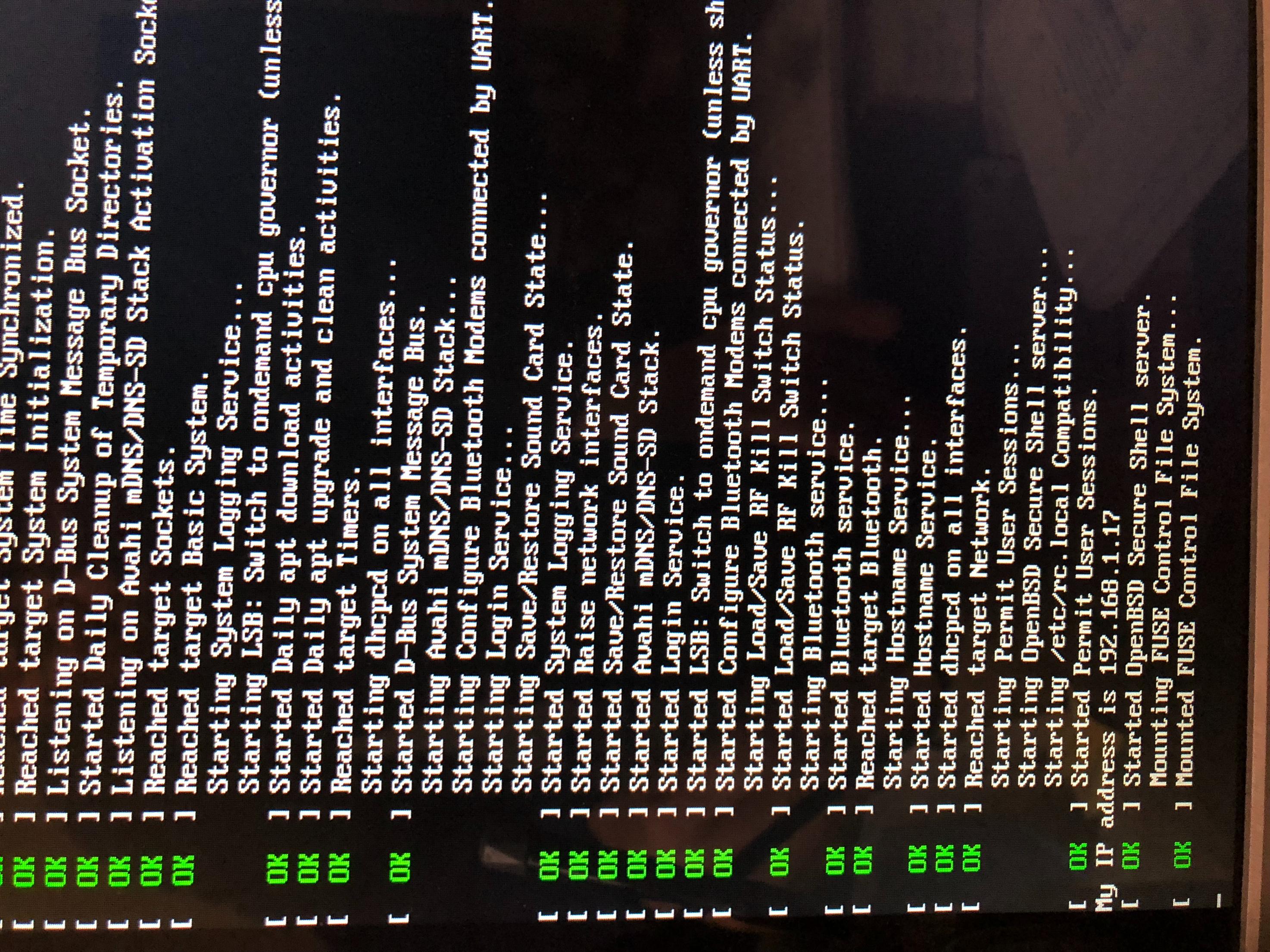

Hi
I think I got it to build and running now. I can start Moode via web browser using
ip address, that is with ethernet line.
When I remove ethernet line and switch to Edimax USB Wifi Adapter, how can
I find out what the IP address is, since Moode running on Pi, will just have blank
screen with occasional yellow light bolt on upper right corner.

If you have an Android device, you can use the Fing app.
or
If you have a Windows PC, you can use the Glasswire app.
its like easy
