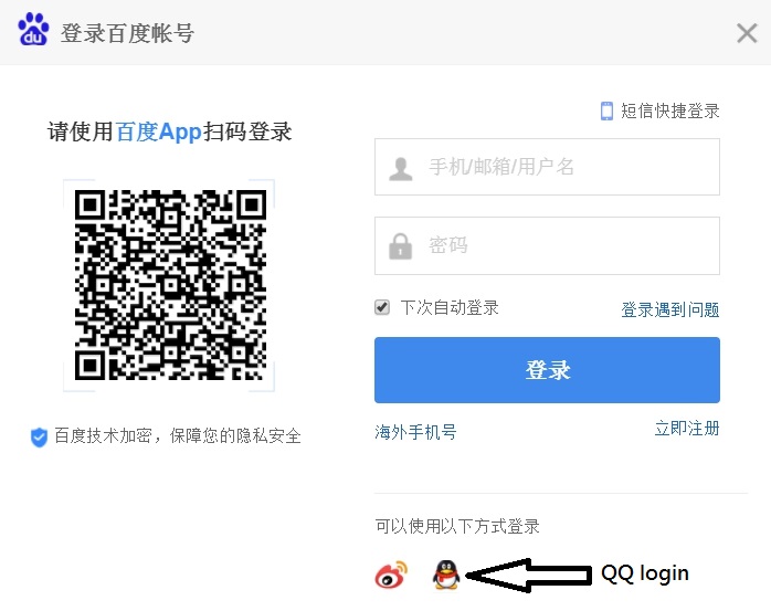

The taobao seller provides image files for moode, volumio, runeaudio, Dietpi, Tinycore with DSD128/PCM384 or SACD-ISO.
Image files can be download:
树莓派等ARM板播放软件_免费高速下载|百度网盘-分享无限制
You need to install Baidu Netdisk first.
http://sw.bos.baidu.com/sw-search-sp/software/57cf90c2afd18/BaiduNetdisk_5.7.2.3.exe
Baidu account has to use Chinese mobile phone for registration now. I am a registered user many years ago. But you can try to get QQ account first using English GUI, and then use the QQ account to login Baidu netdisk.
