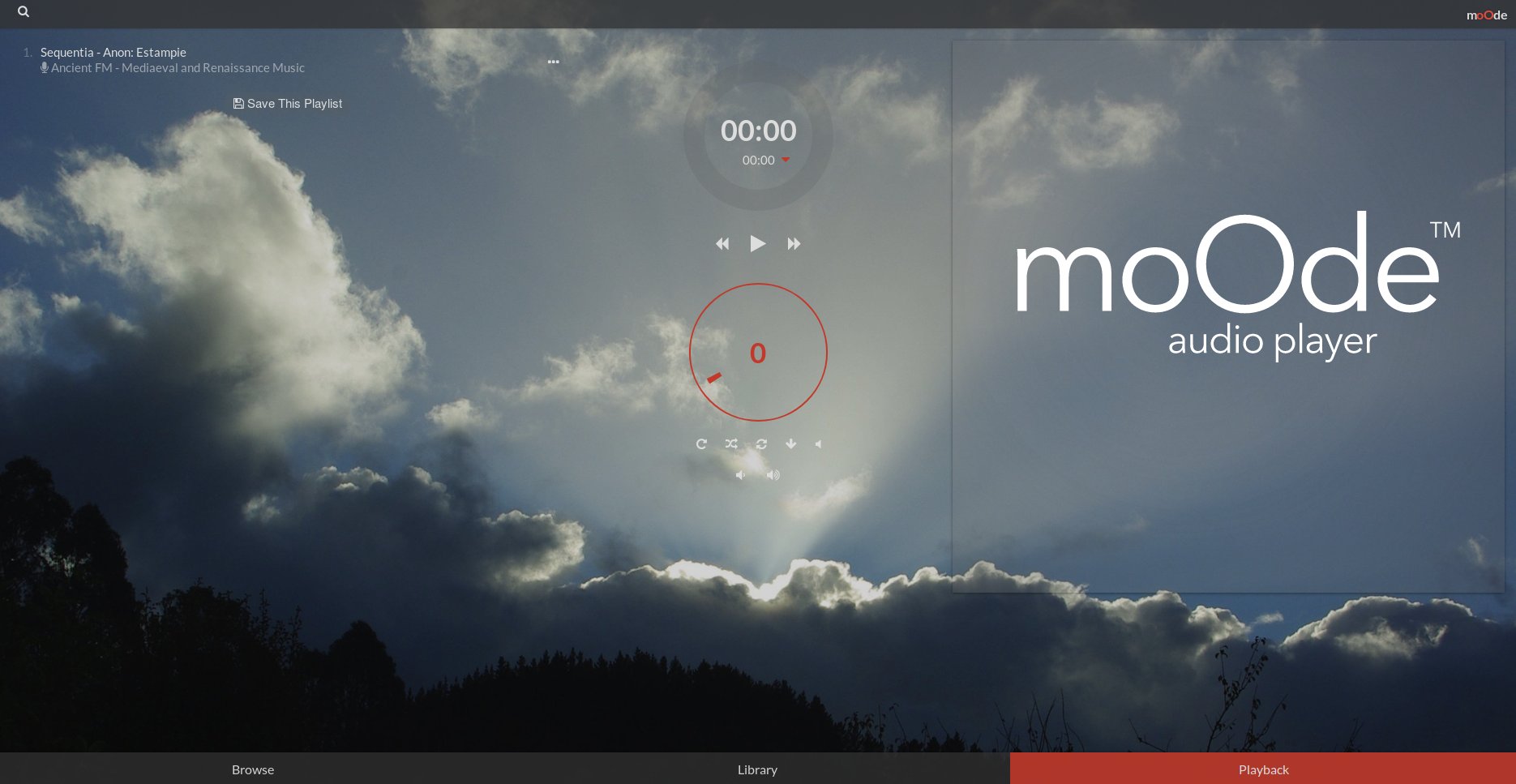

Winter sunrise from the dining room... PiB MoOde4

Dig your background 😀
Edit: there's some sort of rendering problem on chromium browser....
Looks great on firefox 😉
