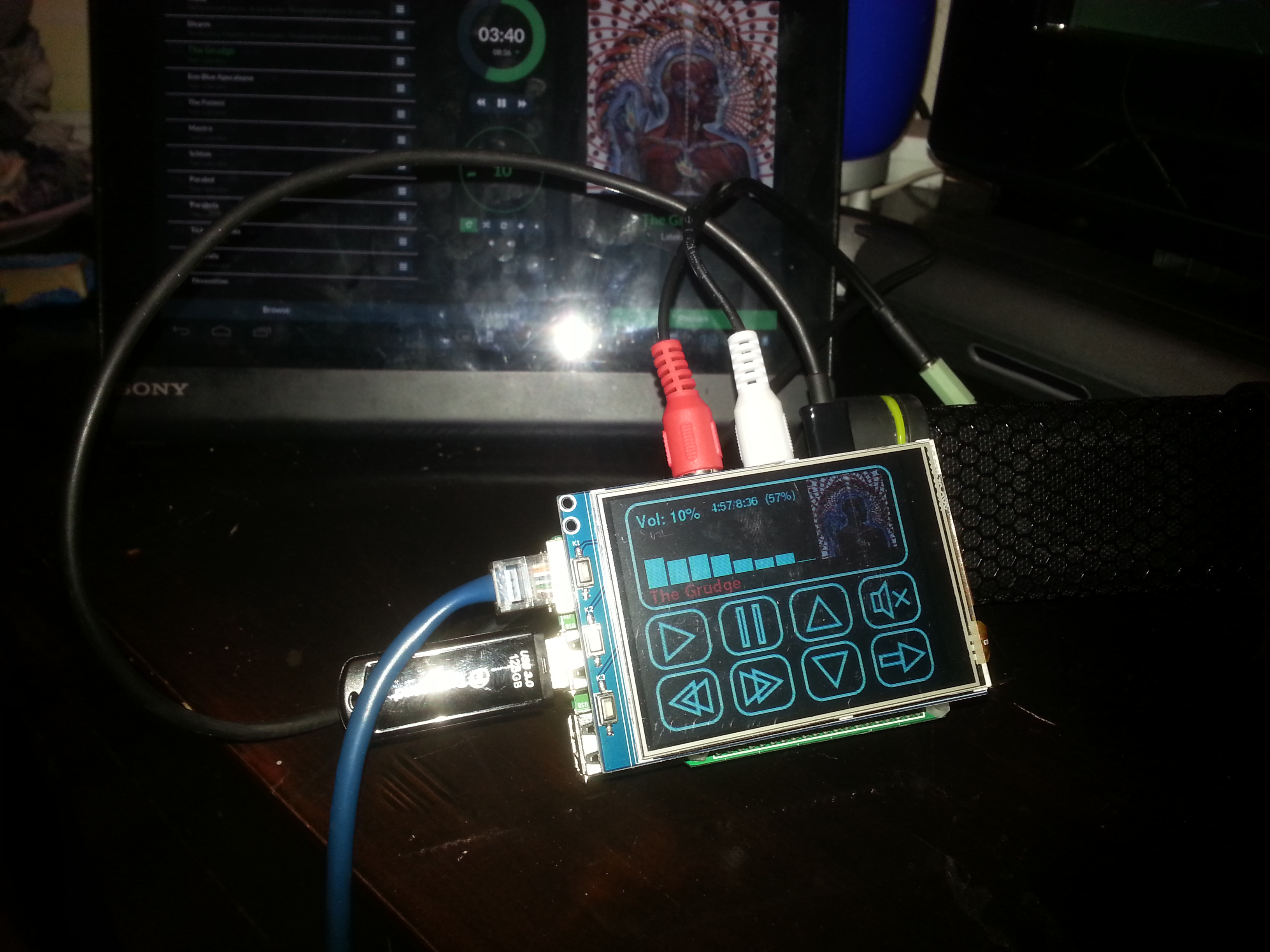

Progress on my version of tron radio for moOde Audio is slow....but steady.
My system is a Raspberry pi 2B
with a hifiberry DAC+ on top,
and a Waveshare spotpear 3.2 on top of the hifiberry.
I had to solder printheaders on the hifiberry to make that happen.
attachment.php

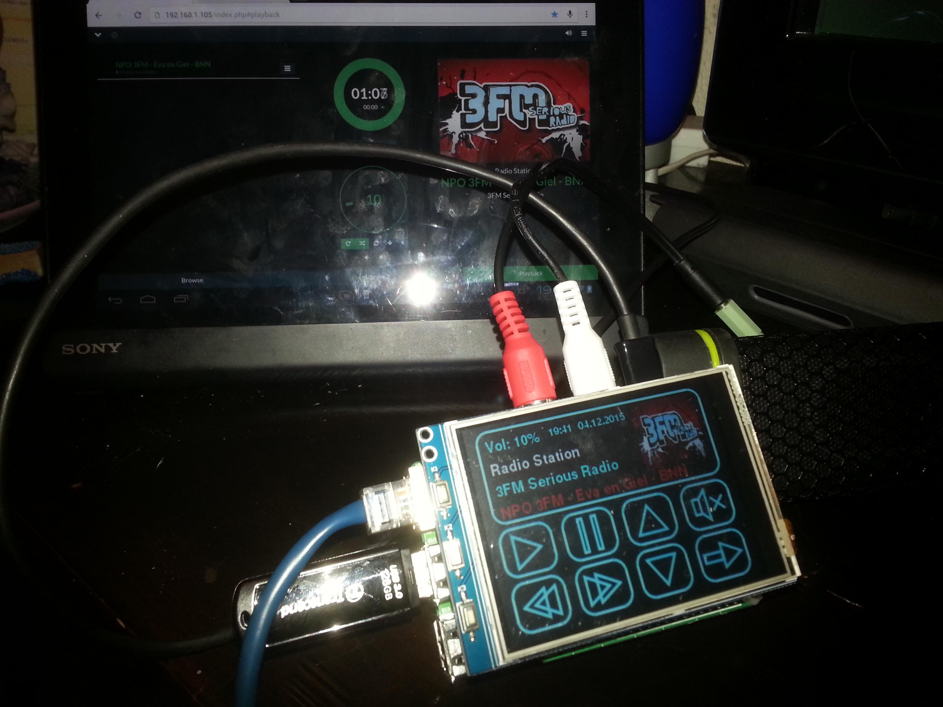

Playing a local radio station:
attachment.php

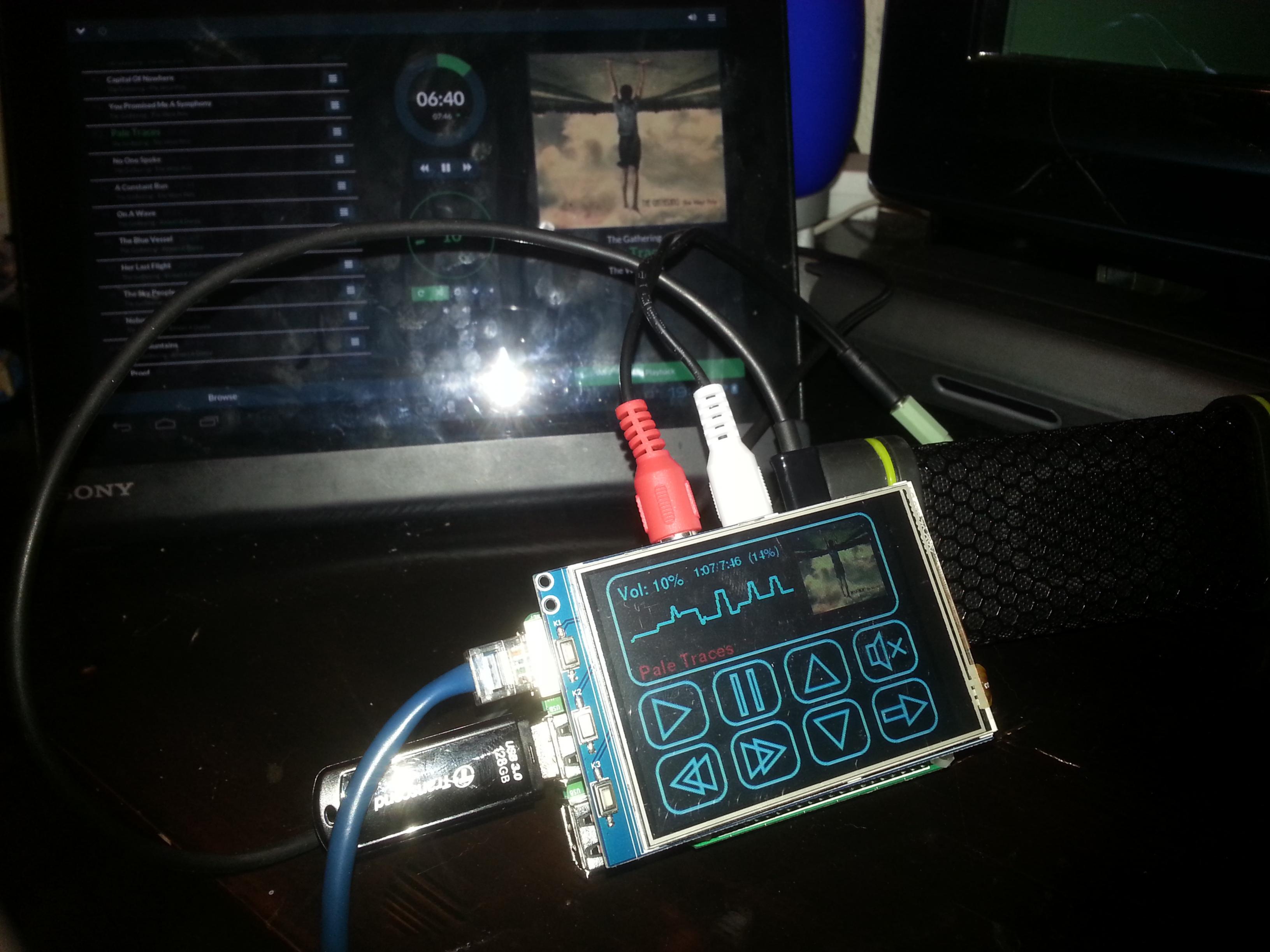

Playing a .flac from usb stick showing meta data:
attachment.php

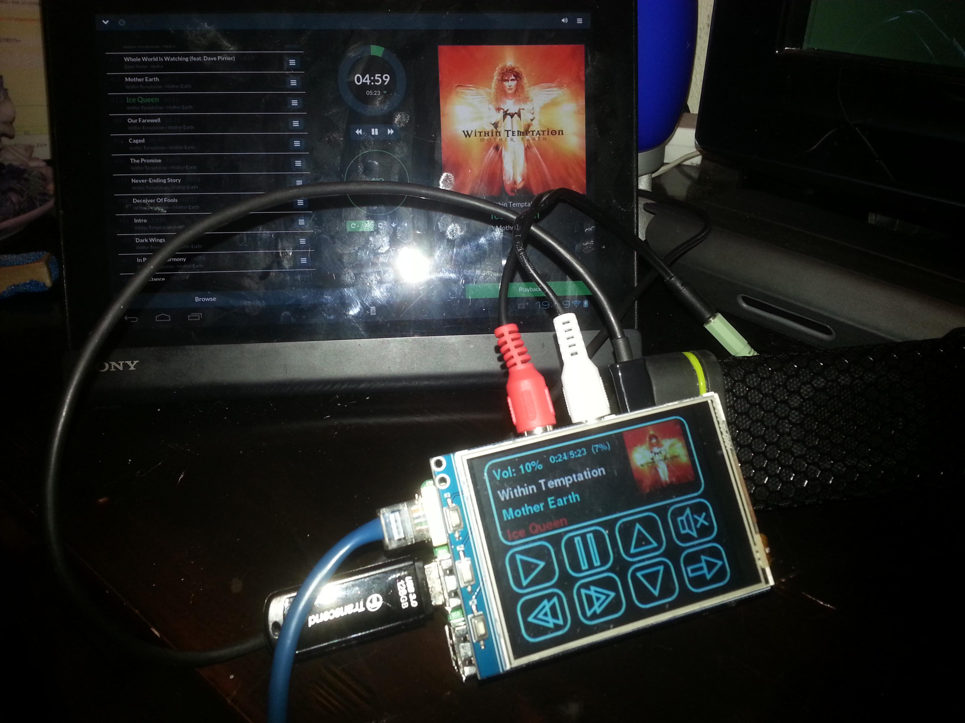

Playing a .flac from usb stick showing a wave visualitiation
attachment.php
Playing a .flac from usb stick showing a frequency visualisation
attachment.php

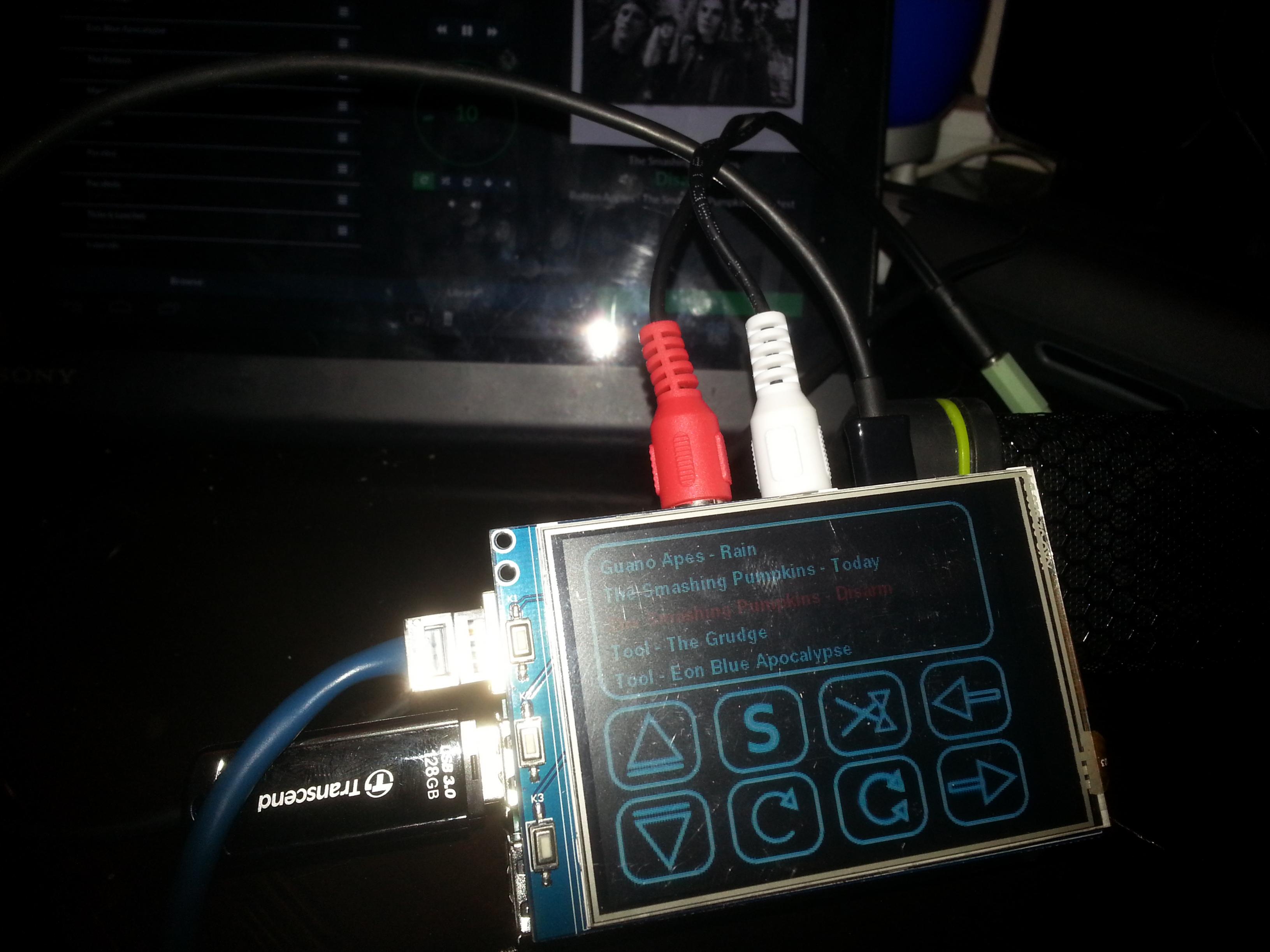

Showing the playlist and select a song from this list:
attachment.php

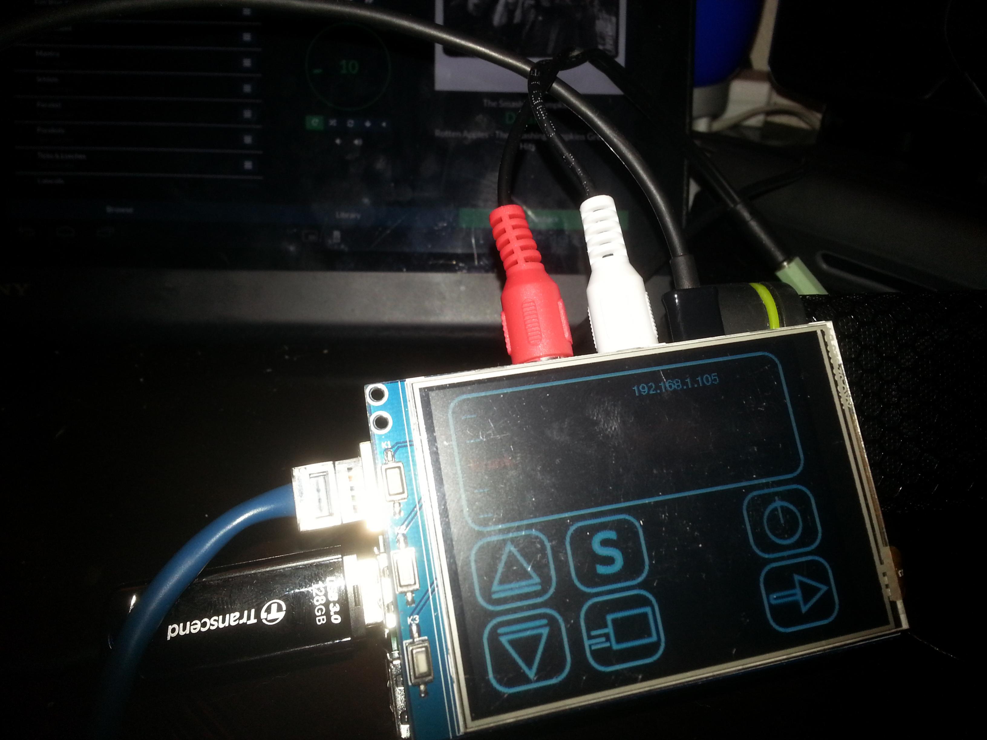

Showing the list of available playlists:
attachment.php
The visualisors (wave and frequency) are not very precise and a bit jumpy. It's more eye candy then anything else. Maybe i can improve the code for this a bit.
Other things to do: add visual feedback for MPD statusses like mute, random play, single play, ect.
And make the list screen a bit better looking
Also i want to add some waiting screens when selecting a new song or new playlist.
I found a problem with the meta data file provided by moOde. It is not updated when there is no browser connected to the player. I have solved this by adding a VNC server (tightVNC) and a browser (Iceweasel) to the software package. By running Iceweasel in a VNC server screen it will force the moOde audio to update the meta data file on every change. Tim told me this will be changed in future releases of moOde Audio, so Iceweasel and tightVNC will not be needed anymore.
attachment.php
attachment.php
attachment.php
attachment.php
attachment.php
attachment.php
attachment.php
LCD on top of DAC board, thats really nice 🙂
Moode 2.5 (Jan 2016) will have server-side metadata logic for LCD interface file so no need to run Browser on server.
