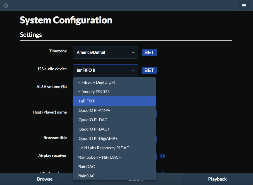

Ahead of schedule on pre-3.0 rewrite of the 2.x code base so took opportunity to fully automate ALSA volume config based on MPD volume setting. It's no longer necessary to manually set ALSA volume when DAC has hardware volume controller 🙂
New config page screenshots plus added IanFIFO II I2S device 🙂
Tim
Tim
