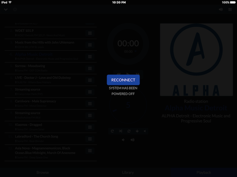

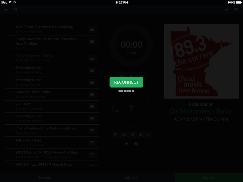

Just a brief update.
As part of the 2.5 code base rewrite there are new smart reboot/poweroff screens. Both screens include a reconnect button and the reboot screen includes a boot-ready ticker that indicates when the reboot is complete 🙂
Tim
