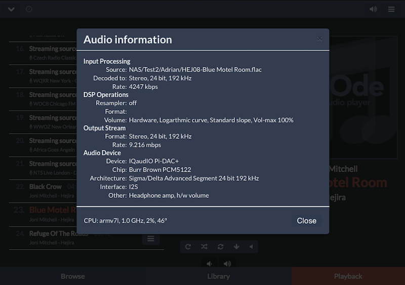

Hi Tim - I've sent a link to 3 files in Dropbox - I hope that's ok? They are some of the ones that cause problems, but I am now suspecting some form of corruption in the files. Does anyone have suggestions on good ways to check the files - since the tests I have done so far (e.g. audiotester) have not shown any problems with the files. Thanks Adrian

Hi Adrian,
Downloading them right now. I'll analyze them and see if I can repro the issues on my test systems. Thanks 🙂

Hi Adrian,
Played all three files and no glitches whatsoever. Audio was perfect, and a really great album btw. 🙂
Refer to attached screen shot. I test with IQaudIO Pi-DAC+ and Mamboberry Hifi DAC+ both of which are I2S DAC's. Resampling disabled of course.
Results suggest the files are OK.
Tim
