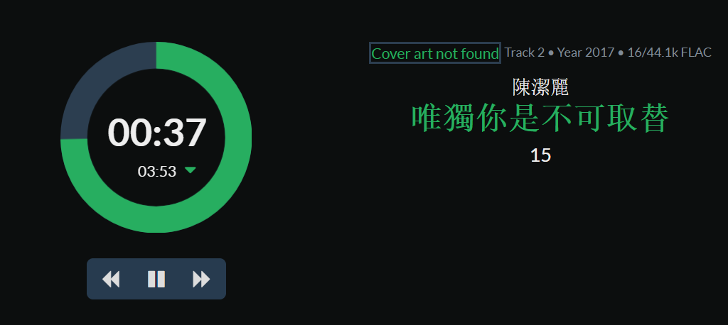

Hi Tim,
My Beta10 also does not show the album art. It says "Cover art not found".
I had cleared the Moode cache. My cover art is jpg stored in the same directory of the music. My folder org. is singer names/albums.
It worked fine on both Volumio and a very early version of Moode 4.0 beta.

Zip up a directory of songs and the cover image file and send me a download link. I'll be happy to try and repro

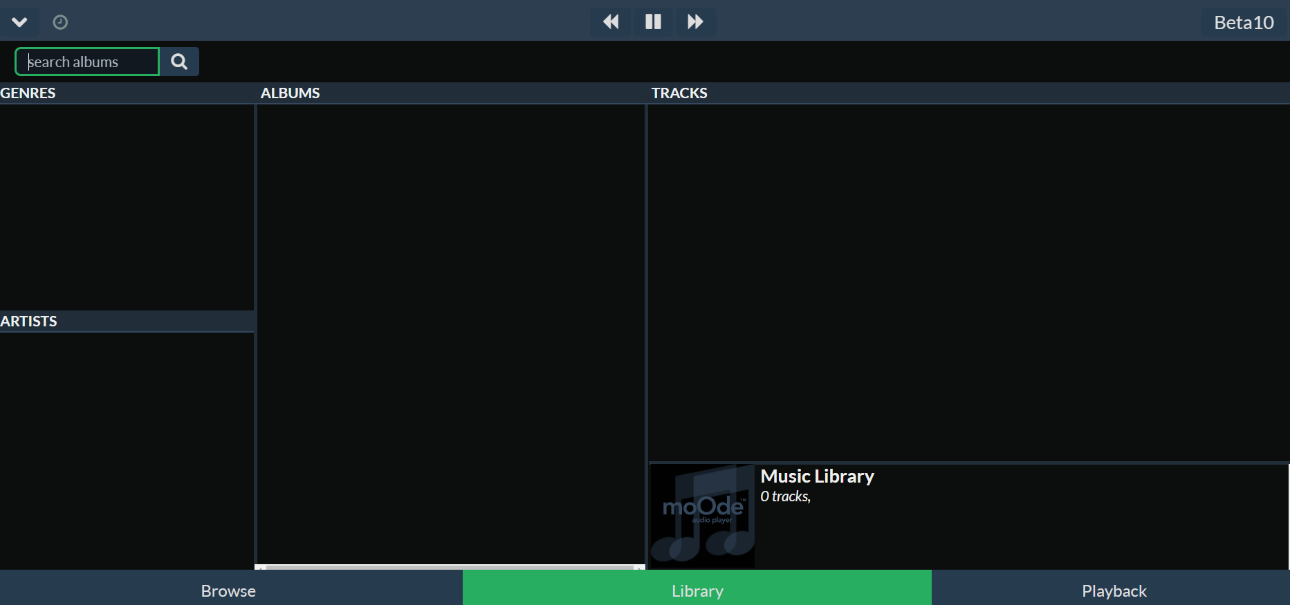

Hi Tim,
Upon further testing, some albums the art work is working fine but the one used to work does not work.
Is there a size limitation on the jpg? The non-working one is 598x578.
Btw, what does the Library tab do or how do I enable it? Thx.
Library shows you all the songs in your collection (as recognized by mpd when you had it scan sources) organized by genre, artist and album.
I expect the same thing but mine is blank

Hi Tim,
In Configure, Sources click RESET Library Cache.
-Tim
No joy.
Tried chrome and edge on my laptop and chrome on my android phone and it is still blank.

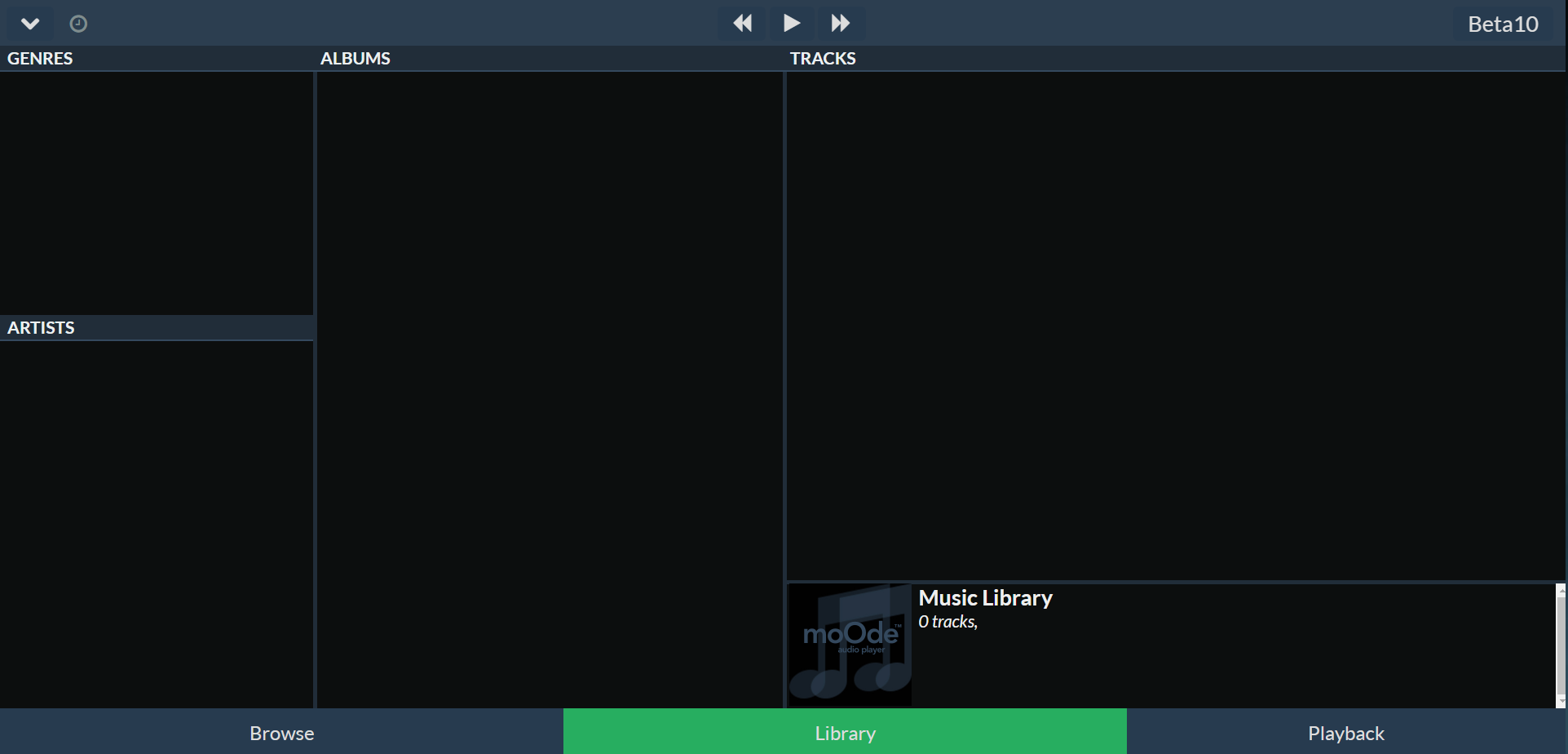

Hi @bigbear2003,
I assume your songs are tagged with Genre, Artist and Album. If not then the Library Panel will be blank.
Is there a Genre named "Unknown" in the Library panel?
Is the Browse panel populated with your collection?
-Tim

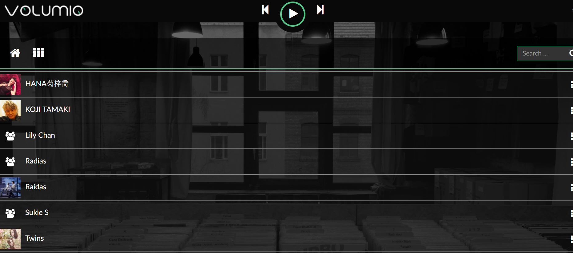

Hi Tim,
Pls refer to the screen cap. Moode vs. Volumio pointing to the same NAS share.

Hi Tim,
Turn on debug logging in System config, refresh the Library panel and then email me the output of cat /var/log/moode.log
