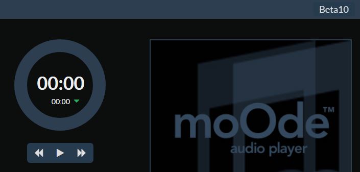

Hi Tim,
Many thanks for your efforts with this
Beta 10 up and running, a clean install from an earlier Beta 8. As with two others I haven't found a way of getting the cover art to display. Does it now need to be a certain size, or is it linked to Chrome fore use with a monitor or display?
The build went smoothly enough, although gmusicapi seemed to hang for a long time at the final bit.
Basically everything is switched to off, as trying to keep it simple at the moment with Allo digione providing spdif output to dac, the audio is fine, just the images haven't caught up yet.

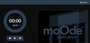

Bingo!
Running Raspberry Pi 3 with an IQAudio Pi-DAC PRO, I have successfully catalogued and am efficiently accessing a library of over 136,000 files. I am using a 2TB Western EasyStore USB 3 drive plugged directly into the USB port on the Raspberry for its power.
I literally registered for this forum looking for confirmation of these two items. Many thanks to you, good sir.
