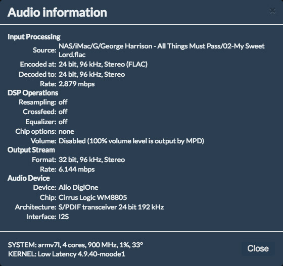

Hi fellows,
got the several-times-seen-issue 24/96 streamed at 32/96. Found posts about but I can't understand when it's normal, a bug, Squeezbox related or ALSA stories. Of course resampling is disabled. Moode 3.8.4.
What annoys me most is that it is (for all) 24/96 files, output stream 32/96, then Allo DigiOne outputs 24/192 max. Are these extra bits 0 for any reason or resampled?
Thanks!
The data gets managed as 32 bit samples inside squeezelite - always!
I guess MPD is not working any different.
And yes, so called zero-padding takes place to fill up the 4 bytes with 0s.
The DAC tells ALSA - the Linux soundlayer - what bit-depths are supported.
ALSA handles the conversion if you choose "plughw:0,0". That means you can output 16bit from squeezelite and if your DAC just offers 32bit, ALSA will do the 0-padding.
If you use "hw:0,0" as output, squeezelite has to deliver exact the bitdepth as supported by the DAC. Otherwise it won't work.

If the DAC offers several bit-depths you can use either of these.
Bit-Transparency in strict terms pretty much doesn't exist nowadays.
That's no flaw though - especially if only 0-padding is involved.
Enjoy.

Glad its working.
It would seem as per soundcheck's observations the creators of the code MPD and Squeezelite decided to work at 32 bit precision. As you point out we are tied to 24 bits by the WM8805 in the digione. I think we will have to live with this. You could start a debate along the lines can anyone hear the difference between 24 bit and 32 bit recorded/encoded data.
Diving for cover.
No issues with 16 bit data either, its is just padded out with the necessary zeros when processing at 24 or 32 bits. It should be completely transparent, so there is nothing to worry about on that aspect.
It appears that many DACs require 24 bit data to packaged as S32_LE with the eight bits of zero padding even though they are capable of only 24 bit depth. So, yes, nothing to worry about, it seems.
