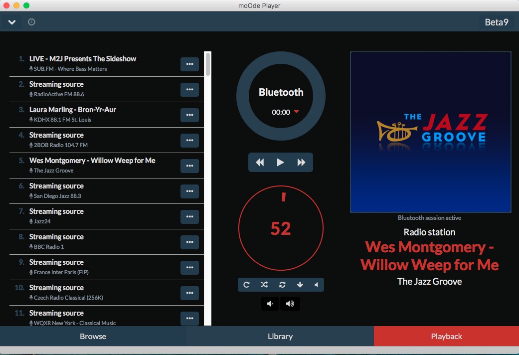

Running Rpi 3 with MoOde beta9. With BT initialized and configured on beta9 and paired to my MotoG5 as the source I am able to send music from phone through BT to my analogue speakers. The issue I am having is the sound is choppy. Consistently the sound cuts out every 4 seconds and then carries on for another 4 seconds. Is this most likely due to my environment or my MoOde install / config?
If you’re using wifi and BT, that’s the most likely cause - they share antenna and attenuator and if using both will be constantly be swapping back and forth between the two, as well as from transmit to receive. They can coexist, but if you have other BT devices in range, the constant scanning/discovering process can be very wireless-disruptive. Turn off any BT you’re not actively using.
There I sn’t much infrastructure between the BT device and the player - check usual things like metal cases, noisy power supplies, routers, fluoro lights (including low-energy bulbs).
So much wireless on the 2.4GHz band, but BT does spread-spectrum jumping about. Maybe push your home wifi up to a higher frequency (ch 9, for example) and doing a scan of what is around may help? The worst culprits for wireless interference are those tasks that try and check status - ‘are you there?’ ‘Are YOU there?’ ‘yes, I’m here, whatcha doin?’ ‘Just hangin... whatchoo doin?’ ‘Nada...’ ‘cool...’ ‘whatcha doin now?’ ‘Same as’... 🙂
In theory, the maximum bitrate is 2.1Mbit/sec. if you are pushing high-bitrate source, it might not cope, so be aware of big FLACs.
In my experience BT is great for exchanging bizcards, swapping text files and printing.
Without knowing anything about your environment it’s pretty hard to give a diagnosis. Try turning stuff off and moving stuff around.

You are correct, running wifi to connect Rpi to the NAS and internet. Other potential BT devices that may conflict my sons Bose wireless headphone, BT mouse on the Mac. Tested with only mp3 podcasts, no flac. I just changed to channel 9 and scanned again but the cutting out problem is still there.
In my case, there is not that great of a use case for BT audio so I am not going to sweat it. Need to spend time working on scratch building recipe. I am going to drop STEP 10 and see if that does the trick.
I have just managed to connect a Lenovo Yoga tablet to Moode Bluetooth.
Started to play JB-R2 through the Tunein pro app and was suprised to hear music.
This did not last for long as it started to buffer every 30 secs or so.
Switched the stream from 320 kbps MP3 to 64 kbps AAC and it seemed pretty stable.
Then tried BBC 6 vi the BBC Radio iPlayer app and Guy Harvey seemed as normal.
Returned to the 320 MP£ stream on JB-R2 and that seems to have settled down.
I'm using a rpi3b with Ethernet to a Switch and Ethernet to the Router.
Distance between Pi and Tablet is 3/4 metres.
