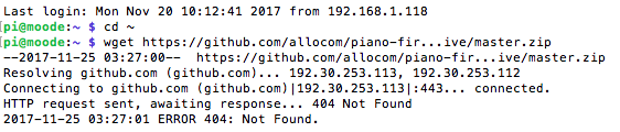

What would cause the files to get "nuked"?
Tried several times to get zip file tonight. No luck. Did you have any problems accessing zip file? Thanks
I used " wget https://github.com/allocom/piano-fir...ive/master.zip"
