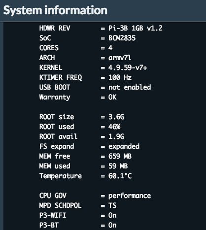

Running MoOde 4.9 Beta for the first time. As someone with SNHL in one having the EQ to compensate is fantastic!!! Have not been able to get BT to work. In Bluetooth Config screen I selected intialize and click on RUN. There was no indication on the screen that any action was taken. Have tried selecting scan for devices for grins. Again no apparent action was obeserved or ability to pair.
My system ino screenshot attached. Any sugestions would be appreciated.
