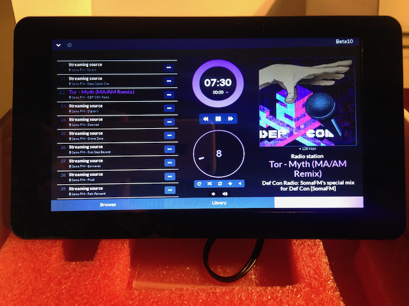

Thanks to Gordon at IQaudIO for providing a nice 7" Touch display for testing 🙂
-Tim
