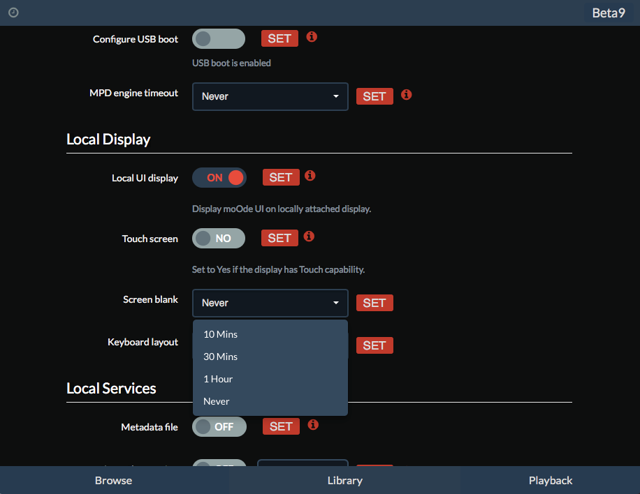

I'm looking for a few good souls to test the new Local display feature on a Pi 7" Touchscreen before I release Beta10.
If you want to try it out send me an email.
-Tim
Pi 7" Touch working perfectly 🙂 Beta 10 should be available this week.
-Tim
