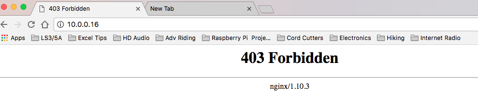

Using recipe 1.9 Completed Steps 1-11 with ethernet connection between router and Oribi router satelite. In Step 12 I enter the ip address of the RPi and I get slammed with 403 Forbiden. I repeated Steps 1-11 again same result 404 Forbiden.
I noticed the green led on the Pi flashes at a variety of intervals but no matter how long I wait, never able to get Nymeria or the Ip address to launch MoOde.
Did anyone else ever run into this issue? Thanks
