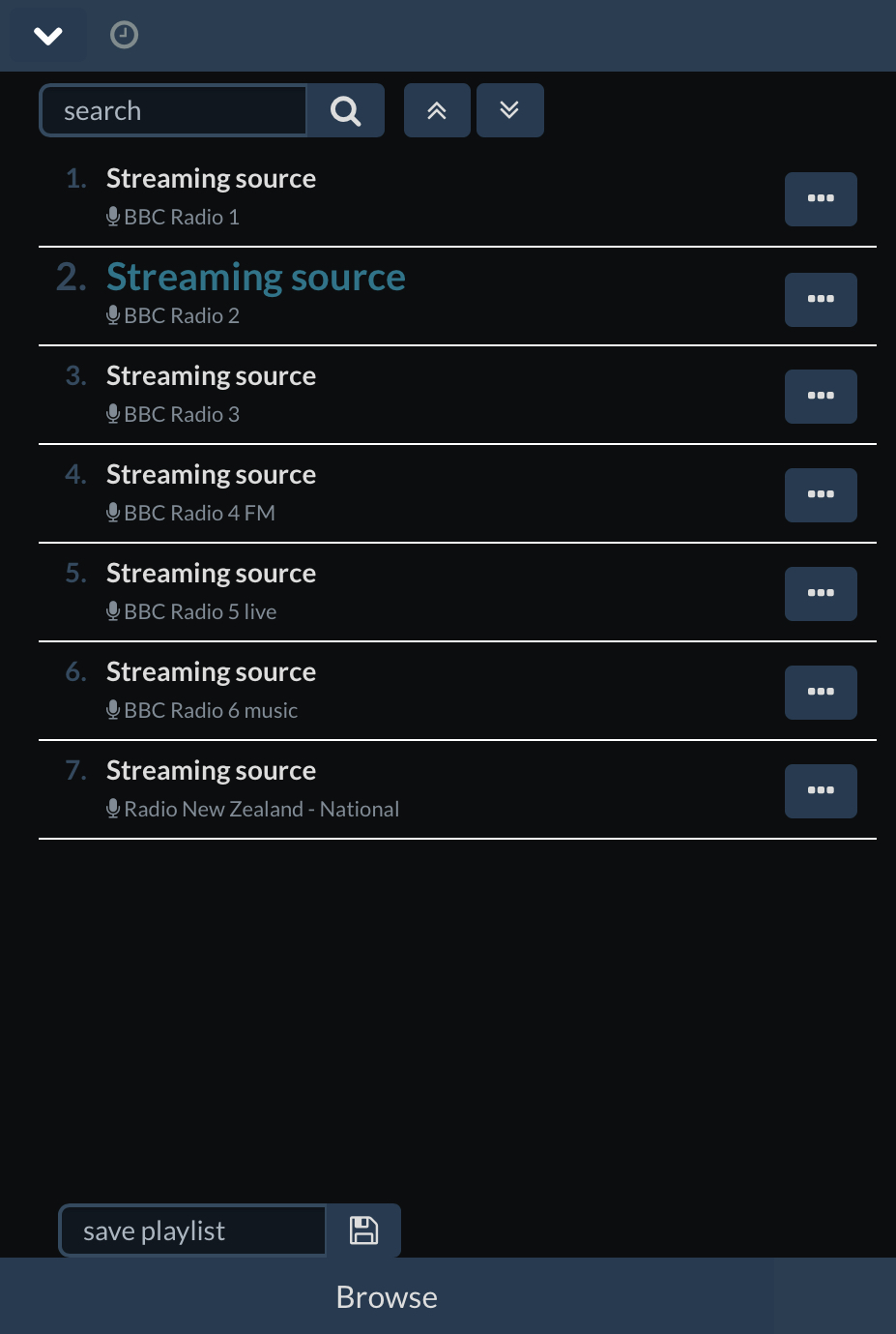

Making playlists is simple:
Add the files to your existing playlist and tap the small inverted-caret shaped icon in the top-left corner. This will open the search field and, at the bottom, open the ‘save playlist field.
If you have persistent album art, you may need to flush your browser cache (ctrl+r, shift+ctrl+r, depending on browser)
