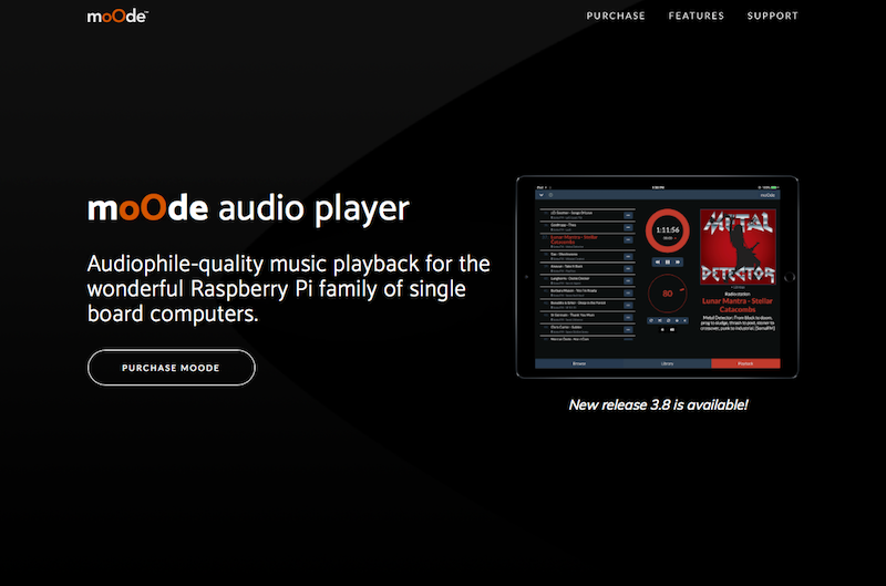

moOde release 3.8 is available at moodeaudio.org.
This release includes a great set of new audio capabilities and is built on a new moodeOS 3.0 platform using Raspbian Jessie Lite 2017-07-05 and Linux 4.9.40 Mainline and 4.9.40 Advanced Low Latency and Real-Time Audio kernels.
- Allo Piano 2.1 owners get full access to this DAC's features including Dual-Mono mode, Hardware volume control and 384K for the dual modes. Allo DigiOne and MiniBoss are also supported.
- MPD has been recompiled to version 0.20.9 using only libav codecs for reliability and consistency.
- There are also a variety of User Interface improvements and convenience features including on the Sources screen, "RE-MOUNT All NAS sources" and "RESET Library cache". This means fewer trips to the command line for routine operations.
Due to the change in OS platform this release is whole-image only. Existing moOde Product Key holders can upgrade to this release free of charge. Simply download the image zip and unlock it. 🙂
Enjoy!
-Tim
