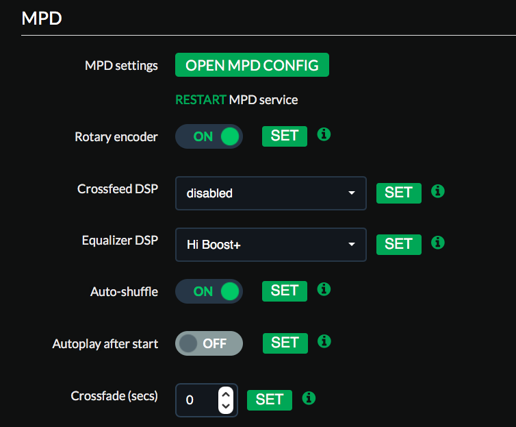

Don't press consume mode, just press the random play button and consume mode btn should light up.
If a track is not automatically added to the Playlist then the problem is external to the Auto-shuffle feature. I use it all the time and never any issues.
After pressing the Random play btn the Auto-shuffle process should appear in the output of PS.
pi@rp3:~ $ ps -A | grep ashuffle
26902 ? 00:00:00 ashuffle
-Tim

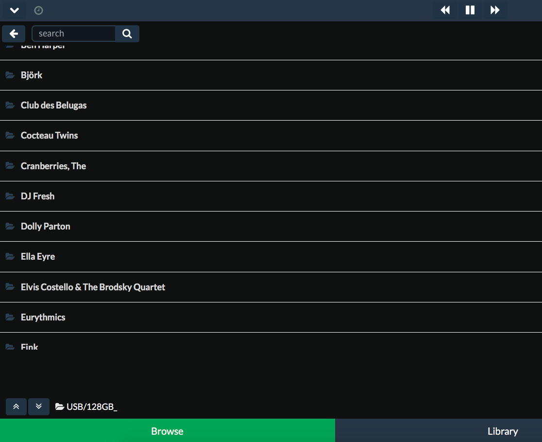

Let's take it right from the start.
Refresh your SD - I use Apple Pi Baker on the Mac, Etcher on the PC, but there are any number of good utilities that will work - on a Mac or Linux box you can write your SD card with OS-level utilities.
Insert your card and a USB flash drive with some music on it into the pi, boot, connect to the network and go to 'configure>audio' - don't worry about your DAC - just go directly, select the auto-shuffle option in the MPD subsection and hit 'apply'.
Select the 'browse' panel at the bottom, right+mouse on the 'hamburger' to the right of USB and select 'update'.
Browse into USB and select a single track. Right+mouse on the 'hamburger' of a single track and select 'clear/play'.
Select the 'playback' panel at the bottom and you should see the single track you picked playing. Pause it. Select the 'random' icon. You should see the 'consume' icon light up, a random track appear as the second item and start playing.
I just completed this procedure on a fresh disk image with a Pi3 and it performed just as I described.
Yours should too, or you are looking at some sort of manufacturing fault or hardware fault - maybe a dodgy SD card?

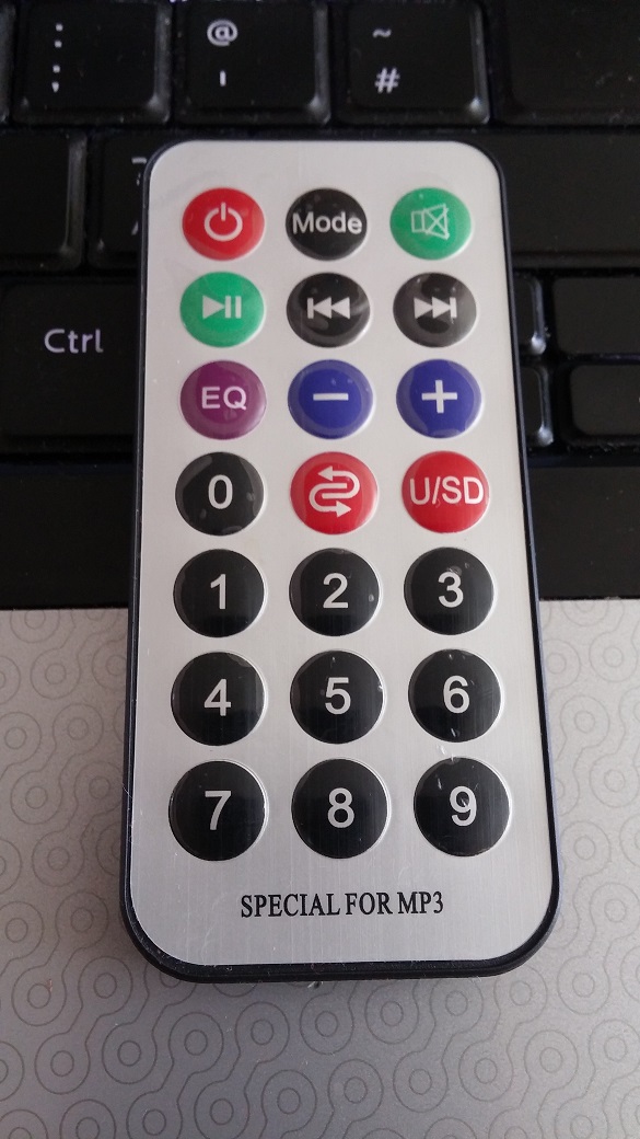

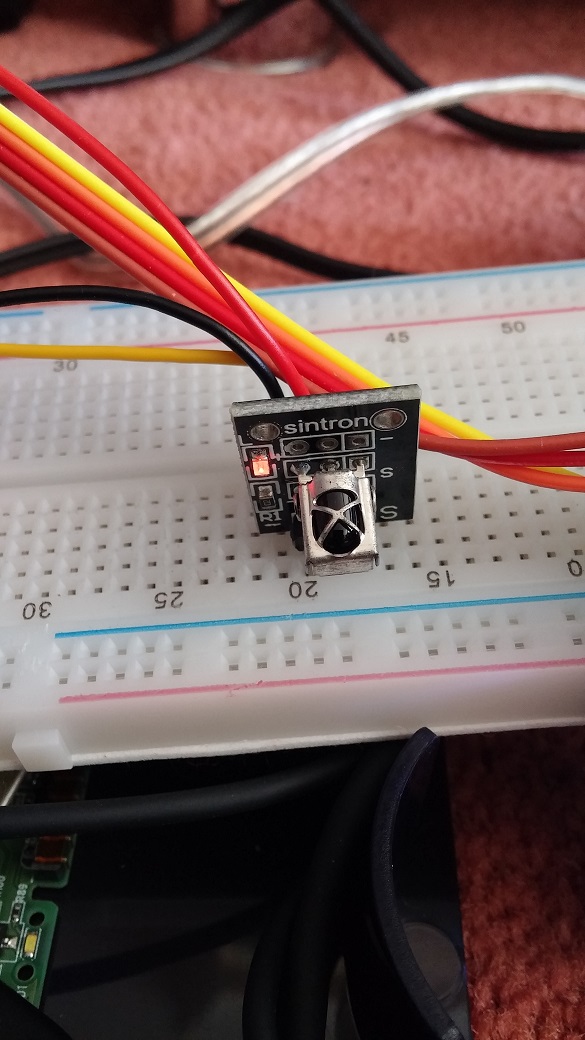

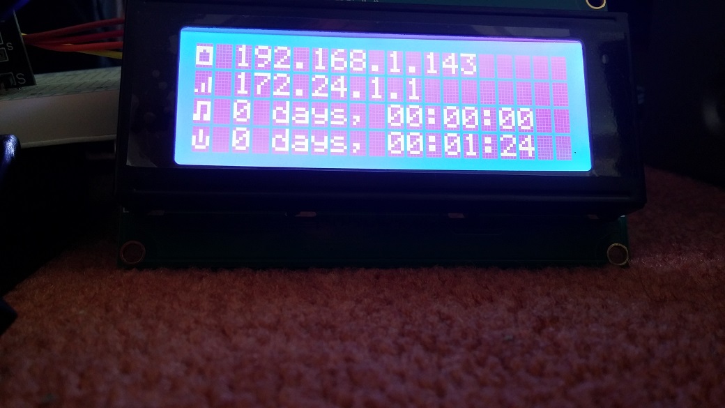

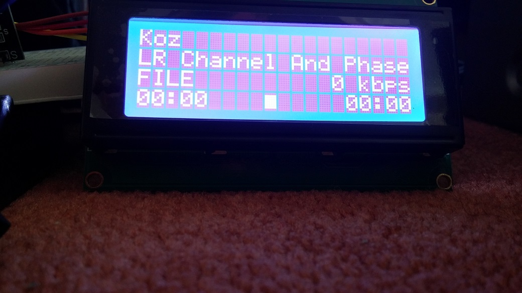

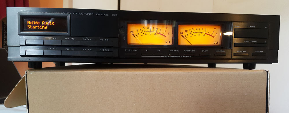

It has taken me over three days to try and get my four line display show the two other screens, IP details, CPU details.
Many problems caused by so much information on the web and half of it seems to be wrong due to different hardware and operating system versions.
Anyway, it all sort of works other than sometime when you use the IR it sends characters also to the console often starting with tty1 (either 7" PI Touchscreen or a monitor via HDMI).
I can find no answer for this and my only though it is because with MoODe Audio the screen is normally blank once booted.
I am using a Pi 3 Model B.
Anyway, with luck screen images and instructions attached.
I am only using the first two buttons of the remote which came with a development kit (with IR Receiver and other goodies).
Buttons are my next test.
@IM35461
I confess I'm feeling a guilty pleasure as I follow along. This could be happening to me!
Re info on the web, you should acquaint yourself with the Infinite_monkey_theorem
As for the stray-character problem, I'll reserve judgment until I get a chance to read your code.
Keep on truckin'
Kent

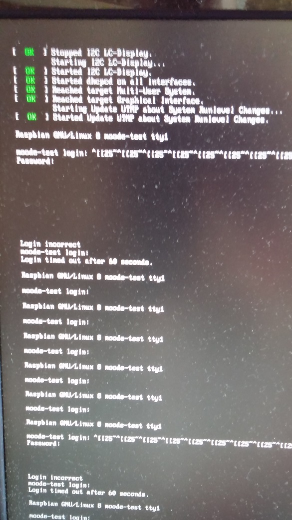

The output to the console you get is as per attached picture.
This happens even when the main console is not even logged in but does not happen to a putty session.
Keep it up. I have been there myself. It once took me a whole week end to successfully make the oled display work. That's because I had to learn the basics of python so that I could understand the language used by those tutorials you find on the net. I received a lot of help from members of this forum. But the end result can be gratifying as you can see in the attached picture. I managed to install the scripts for pi-supply switch, infrared remote, oled display and hardware buttons for play, pause, next, prev. I can run my Moode audio without a computer or tablet. I just switch on and press the play button on the remote or on the hardware device, which ever is near. My favorite playlist is always loaded and starts playing. Very stable. I love it.
