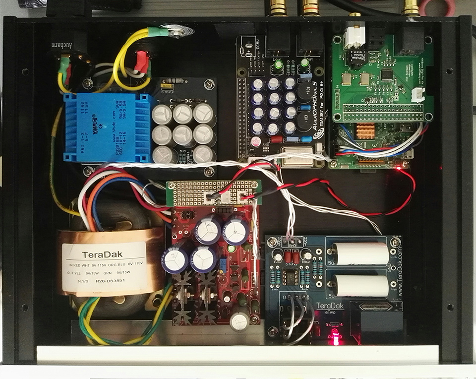

My second moOde streamer build (moOde 2) 😀
digital output part is HiFiBerry digi+ pro, linking to PI3B by using GPIOs 2-3(for configuration), GPIOs 18-21(i2s sound interface) and GPIO16(reserved by HiFiBerry), document here https://goo.gl/zhN3sW
dac output part is Audiophonics TDA1387, using direct i2s link from HiFiBerry digi+ pro P6(bck, lrck, data)
sound result:
1. moOde 3.7 select Audiophonics TDA1387 driver
dac(TDA1387) work like a charm, sound is very good and clear.
digital part output nothing (off).
2. moOde 3.7 select HiFiBerry digi+ pro driver, using digital BNC cable link to my External TDA1541A
digital part (output from External TDA1541A DAC) sounds not good, a lot of pops, not very loud, but can be heard, so bad.
TDA1387 part output sound at the same time, same as digital part, there is a lot of pops, I thinks the pops is from digi+ pro.
3. moOde 3.7 select USB driver, using USB cable link to my External TDA1541A
digital part (output from External TDA1541A) sound is very good and clean. very nice sound.
Waiting for the next moOde version with new kernel to fix digi+ pro pops 😀

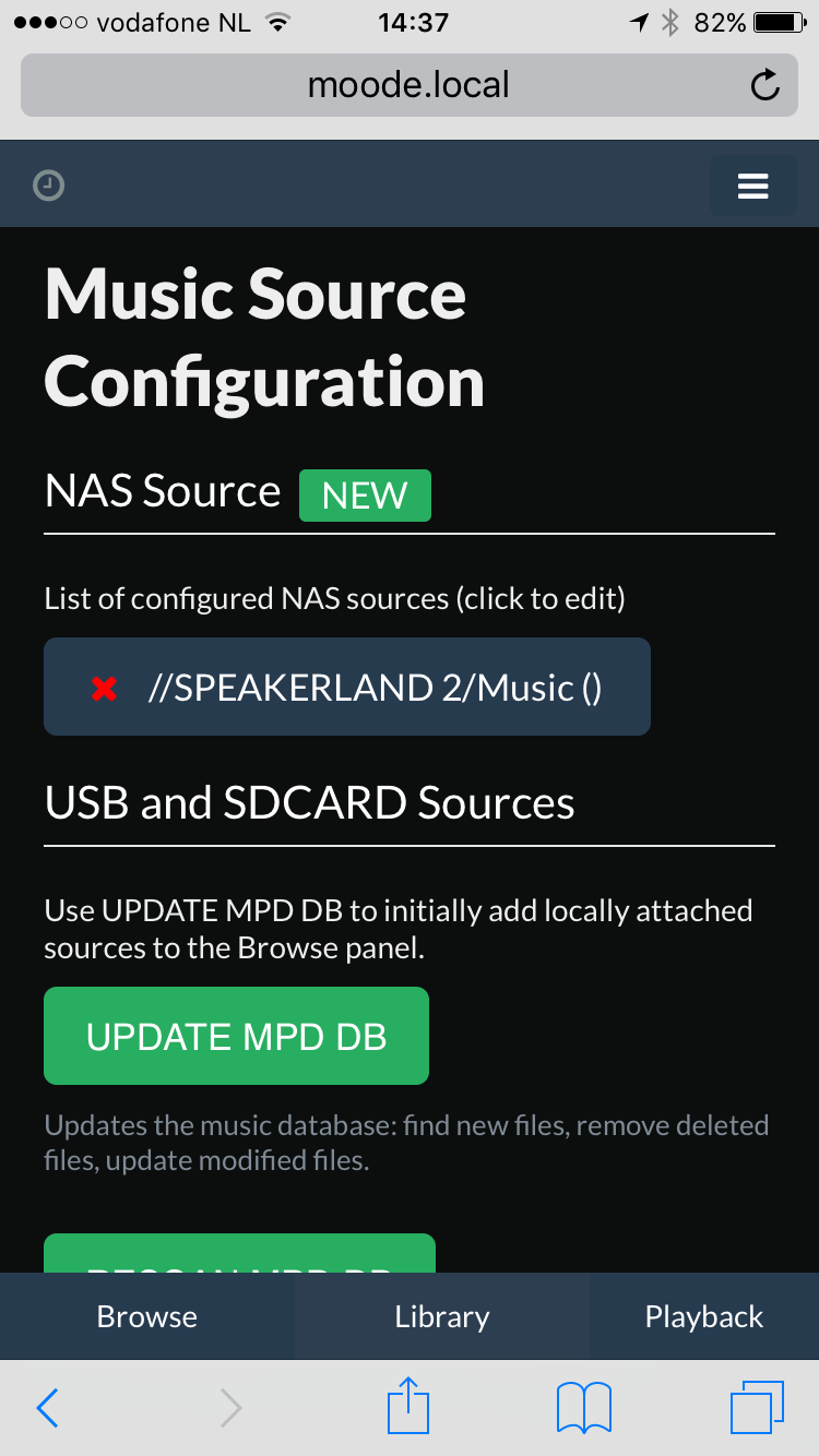

I didn't notice that. Yes of course, host names can't have embedded spaces. The spec for host names is below.
Length 3-63 chars, A-Z, a-z, 0-9, and hyphen (-) are allowed
-Tim
Agreed that a space in a name is tricky/illegal.
The thing is that this NAS really exists and has actually worked with this Pi. Albeit in another network (not my own network).
This issue is easily reproducible with a name of a non-existing NAS.
It is not a big deal: i will reflash the SD Card and je carefull to use the right NAS name.
Martin
Martin
Try the IP address instead, although not your issue you also cannot have the word NAS in name as well.
