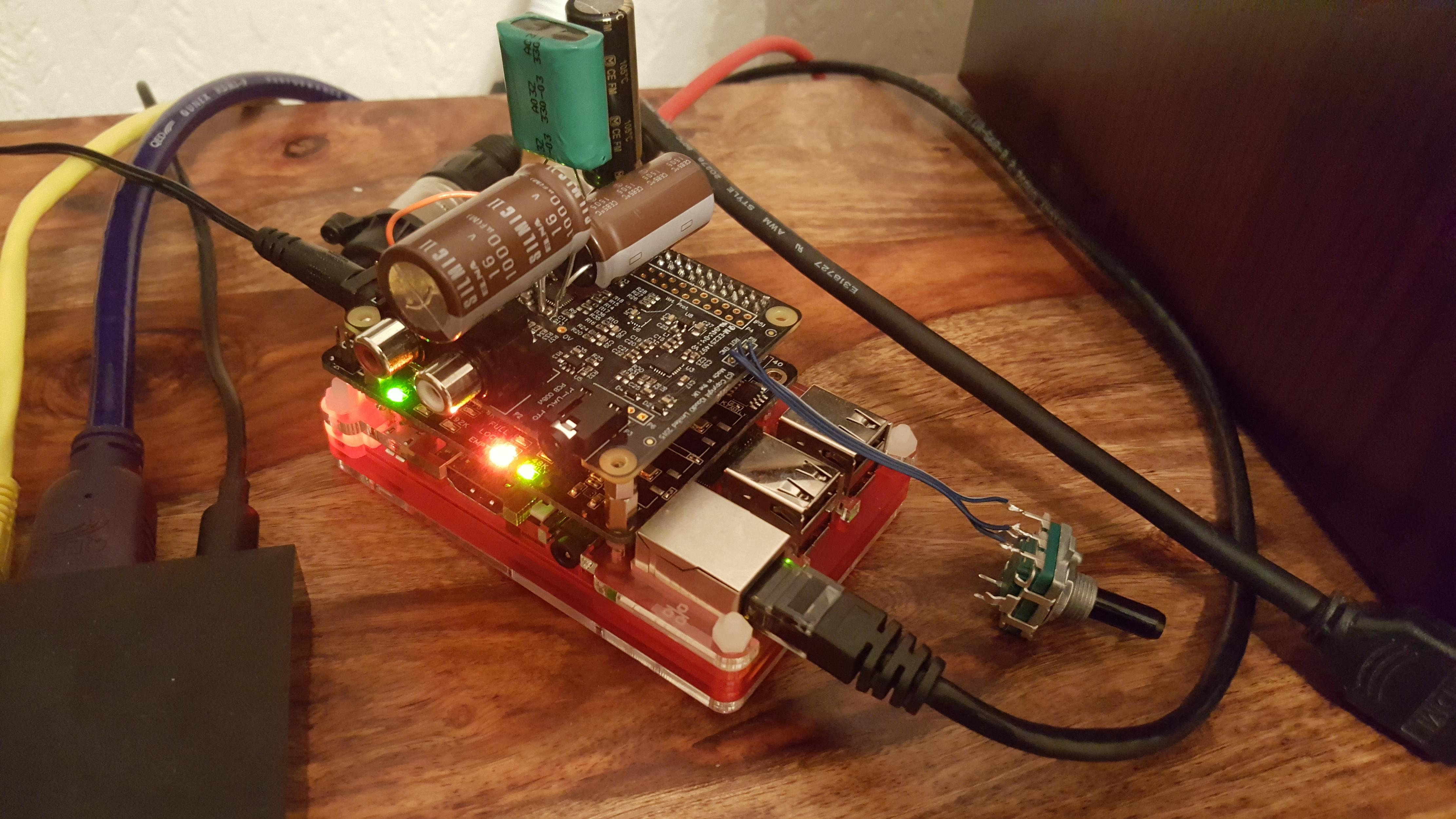

Screenshots or the project doesn't exist ;-)
Prototype lashups using existing boards before I put my money where my mouth is lol 🙂 My finished PCB's to follow.........at......some.......t...i....m...e.....i....n......t..h...e......f.u..t..u..r..e
