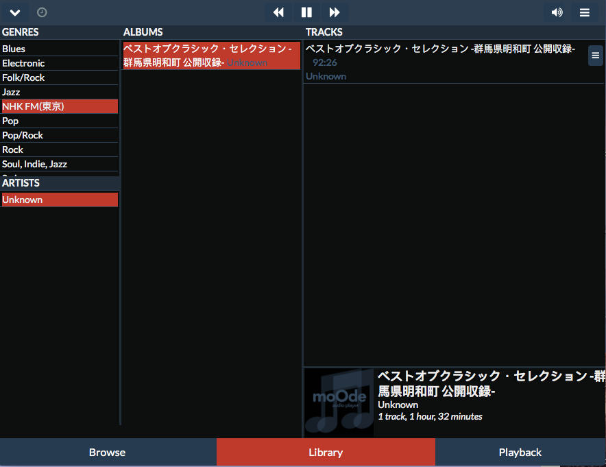

m4a problem
Hi Tim,
Nice work and better sound !!
However I have a serious problem with Moode 3.5.
When I play .m4a files, after while soud is stopping and moode is likely to hang.
I have never experienced such a problem with Moode 3.1.
I try to change the kernel and other settings without success.
I upload the sample m4a file to repro the problem.
https://www.dropbox.com/s/8do789xczrw0h62/20160721.zip?dl=0
RPI3, PCM5122(Hifi DAC+) and other I2S DACs and drivers

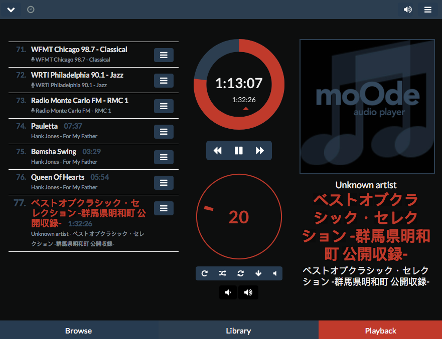

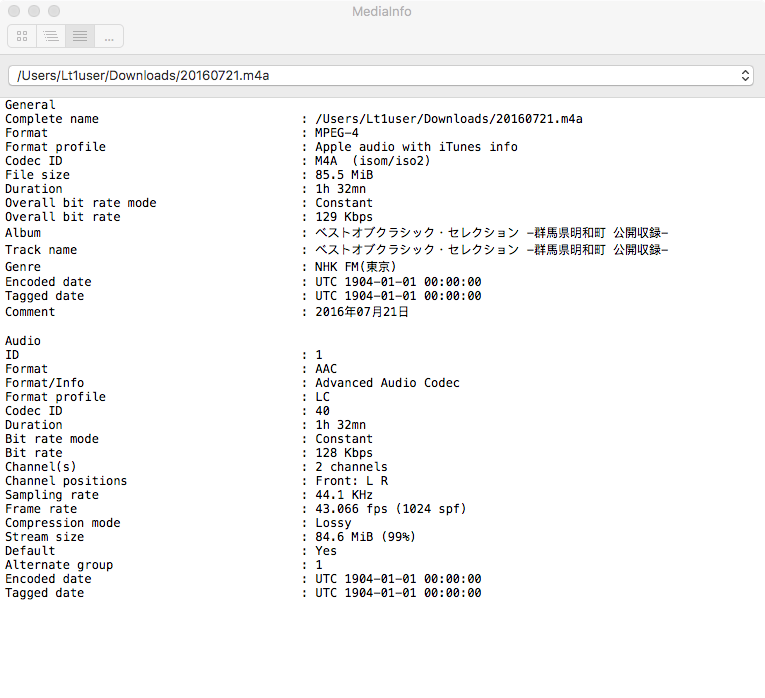

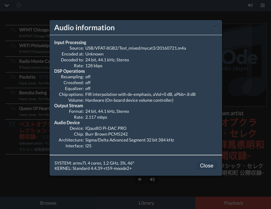

I'll try to repro later this morning.
I see that the track is almost 90 minutes. How long before you experience the issue?
-Tim
Thank you Tim.
It will take a few minutes to 10 minutes to see the problem.
The file played ok for me. I stopped after 1 hour 15 mins. See attached screen shots.
-Tim
