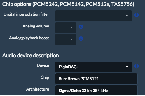

Are the additional chip settings already available for PCM5121 (plain dac+)?
Just tried to select something and the fields are still grayed-out.
As I remember, you've planned to implement it in new Moode.
Yes its implemented but a bug is preventing the options from being enabled for PCM5121.
Will be fixed in first in-place update
-Tim
