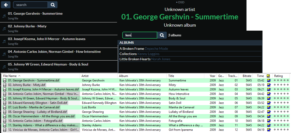

Is there a bug/problem with .dsf id3tag v2.3 recognition?
With foobar/mp3tag/tag&rename there are no problems.
I have done 'update mpd db' from sources and 'update this folder' with no luck.
What exactly is the issue? Screenshots?
-Tim
It won't scan the album to library and don't show id3tag.
It may be related to only this album, I have other .dsf albums that seem to work okay. Strange.

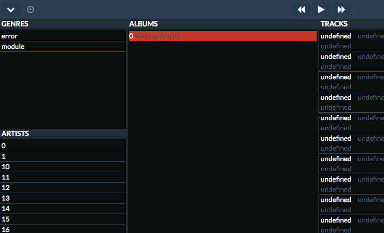

Tim, I'm getting exactly the same error (PiZero + Pimoroni pHat DAC).
In addition:
1. There's also something wrong with library (I didn't add any sources yet)
2. ystem boots in AP mode, then I'm configuring static wifi, then reboot.
Pi wakes up again in AP mode.
Did I miss some steps?
p.s. I've always used ApplePi-Baker (it perfectly worked with previous versions).
