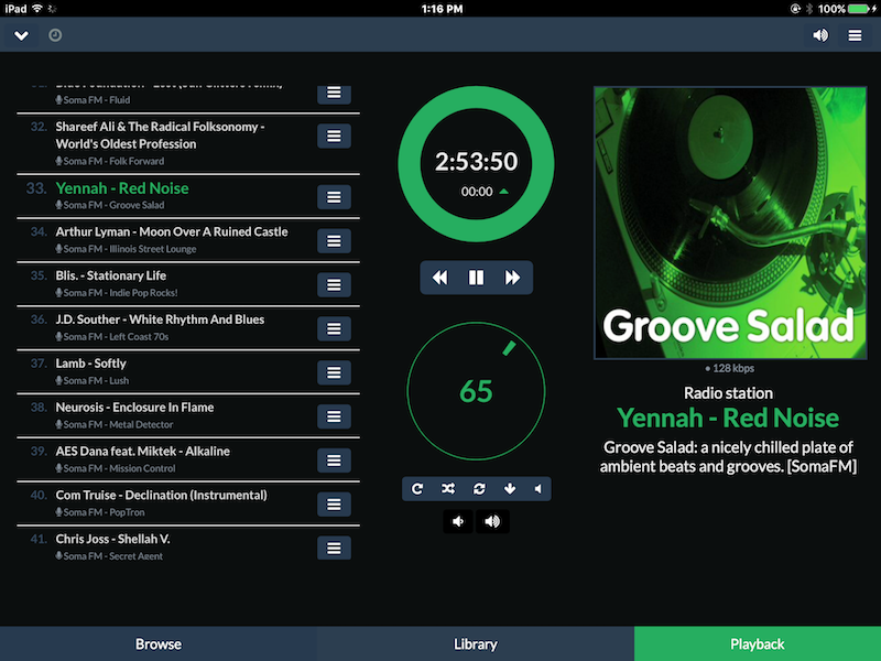

Moode 3.0 and moodeCase are available at moodeaudio.org 🙂
This release of Moode Audio Player includes an Advanced kernel that provides important audio capabilities and low latency performance, Squeezelite renderer, enhanced MPD features, new version of shairport-sync, improved resiliency to network interruptions, new commercial-free, listener-supported radio stations, support for new I2S audio devices and numerous updates and bug fixes.
Please read the attached Release Notes and view the Setup Guide at moodeaudio.org for more information, and treat your Raspberry Pi audio project to a professional grade enclosure with moodeCase!
Enjoy!
Tim Curtis
3.0 Release 2016-11-27

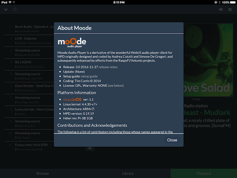

I've been a moode user for a quite a while, though this is my first post here.
I just updated to v3, but cannot finish the setup as I get the mpd-config: connection to mpd failed message when trying to enter the mpd config or sources page.
I'm using a HiFiBerry DAC and a pi1b and have tried to write the sd card with both etcher and piwriter to no avail.
I've set the timezone, expanded the sd card, set the audio device to the HiFiBerry and rebooted in that order. But anything relying on the mpd gives me the error page.
On another note - when I click 'About' I get a #notarget appended to whatever url I'm at. Don't know if there's any relation?

Same here, i use a Pi2 and a Pifi DAC+. It worked with Moode 2.7 with Hifiberry Digi+ drivers but with 3.0 i get the same errors as Jeppe.
And also no 'About' page
