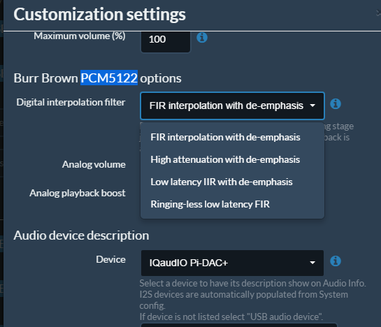

Burr Brown PCM5122 options
What filter should I select for the best sound?
