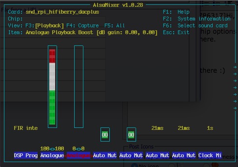

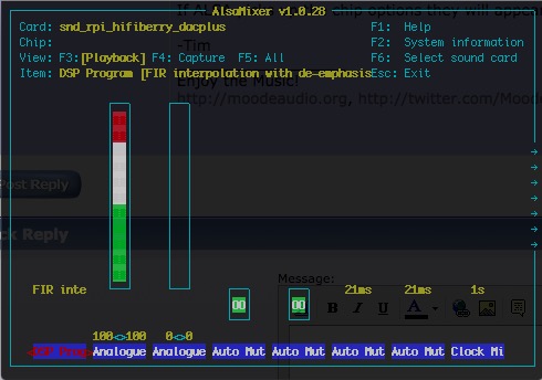

Tim,
I've just got new PlainDAC+ as a replacement of dead PlainDAC. This one has PCM5121 chip (same as 5122, just with 106dB dynamic instead of 112dB).
I think that the "5122 options" should also work for this chip (even on the manufacturer's site they're just called pcm512x). Any chance to activate additional settings also for 5121? Currently, they do not appear in the drop down box.
http://www.ti.com/lit/ds/slas763b/slas763b.pdf
Marek

If ALSA picks up the chip options they will appear in the ALSAMIXER app. Let me know if they are there.
-Tim

Yes, they seem to be there :)

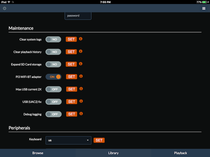

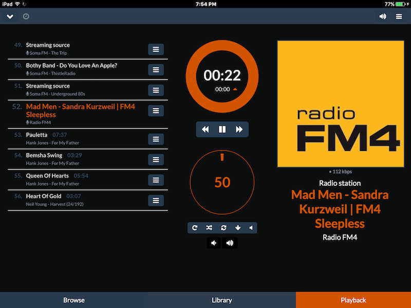

Moode 2.6 2016-07-28 update is available.
READ CAREFULLY
This update can take several minutes to complete due to components that are downloaded and installed from Jessie repo. After pressing INSTALL, if the message "Software update complete, Reboot required" appears immediately, just ignore it and wait several minutes. There is bug in Worker that prevents System config screen from auto-waiting before displaying the completion message. The bug is fixed in this update.
The update process can be monitored by ssh TOP to determine when its ok to reboot. Look for apt-get and mandb running. When they are both finished and no longer appear in list, its safe to reboot.
1) One of the updates installs html files that revert the knob colors to Emerald. Use Customize to set another color, then back to your favorite color, then refresh.
2) The wonderful Crossfeed DSP plugin is included in this update. IMPORTANT: To establish Crossfeed/MPD outputs its necessary to perform the steps below after reboot.
a) MPD config, APPLY
b) System config, set Crossfeed DSP to 725 Hz 4.5 dB then set it back to disabled.
c) The config can be verified by running the cmd below
pi@moode:~ $ mpc outputs
Output 1 (ALSA default) is enabled
Output 2 (ALSA crossfeed) is disabled
pi@moode:~ $
3) Several configuration changes are included that provide improved support for loading large collections into the Library panel.
Finally, it's always a good idea to BACKUP the SD Card before installing updates :)
Enjoy!
Tim

NEW: Setting to turn off Pi-3 WiFi/BT adapter

NEW: Radio FM4
