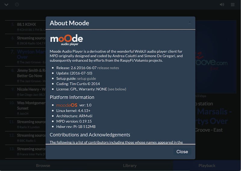

Hello,
for several months, I enjoy Moode just for listening web radio and Airplay services (controlled by iPad 3 and iTunes for Windows).
My only devices: RPi 1B with WiFi Edimax EW_7811 UN or LAN connection, HifiBerry DAC
Moode 2.5 always works like a charm, no problems with Airplay, especially no sound interruptions.
After trying Moode 2.6 (with newest updates by SSH), I always locate frequent music interruptions (sounds like a crash) when I use Airplay. Especially at the beginning of a track, the music stops very ofen after 1-2 seconds, then there is silence for 1-2 seconds. During the track, I perceive further interruptions 1-2 times.
Sometimes, I see CPU peaks of >50% (Menu Audio info). It doesn't matter, if source and RPi are connected wireless or by LAN cable. Perhaps RPi 1B is too old for the complex 2.6 (UI) system. But I am astonished, that there are no other users, who reported this problem. I installed MA 2.6 again and again with no effect.
Is there any possibility to log shairport-sync errors? Or is there any other way to locate the problem?
Moode is a wonderful player, but this problem is very annoying.
Thanks for you support,
Klaus.

Hi Klaus,
I have two Pi-1B's both using WiFi and one with Edimax adapter and no issues with Airplay. No user reports of issue like this.
What device are u using to send the Airplay stream?
-Tim
As mentioned, I use my iPad 3 (latest iOS-Firmware) and iTunes for Windows 12.4.1.6.
To troubleshoot, try the following:
1) ssh pi@moode (pwd=raspberry)
2) ./mlog.sh
post the contents of step #2
3) from Windows PC, run a ping test to the Pi and see if any network issues show up in the ping stats.
4) Reboot router
-Tim
My results of mlog.sh:
Code:
pi@moode:/ $ ~/mlog.sh
20160701 000255 worker: Startup
20160701 000300 worker: Host (moode)
20160701 000300 worker: Hdwr (Pi-1B 512MB)
20160701 000300 worker: Arch (armv6l)
20160701 000300 worker: Krnl (4.4.8+)
20160701 000300 worker: OS (moodeOS 1.0)
20160701 000300 worker: Rel (Moode 2.6 2016-06-07)
20160701 000300 worker: MPD (0.19.15)
20160701 000300 worker: Session loaded
20160701 000300 worker: Debug logging (off)

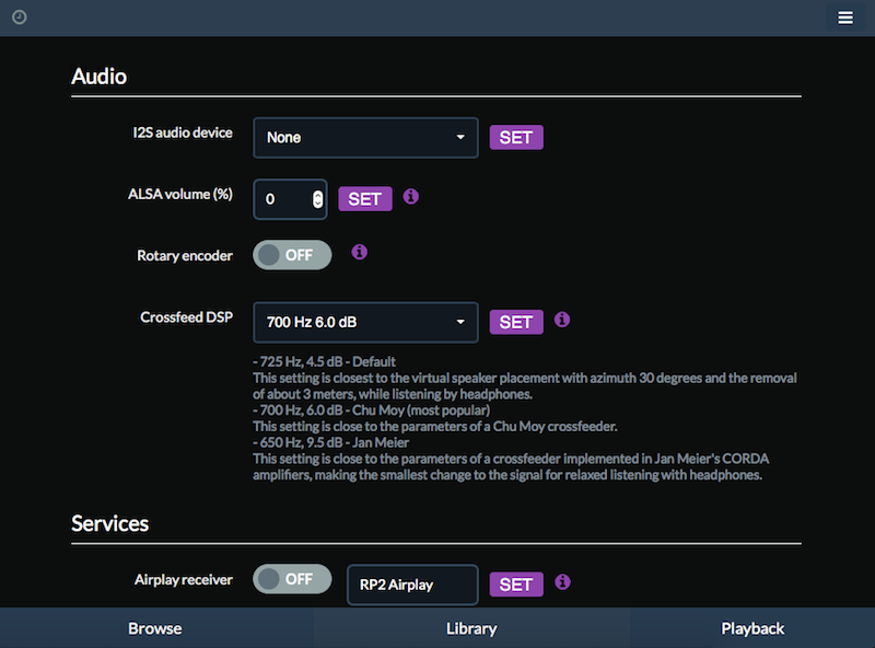

6) The wonderful Crossfeed DSP plugin is included in this update. IMPORTANT: To establish Crossfeed/MPD outputs its necessary to perform the steps below after the system has been rebooted.
6a) MPD config, APPLY
6b) System config, set Crossfeed DSP to 725 Hz 4.5 dB then set it back to disabled.

First review:
Enabling crossfeed I can hear clearly a difference. I'm not used to it, so I'm not going to comment further.
BUG (?)
- "menu->about" not showing correct update version. it shows "Update: (null)".
while /var/www/update-r26.txt shows the correct updated version
Feature request (minor):
- the steps needed to set the crossfeed somehow (your point 6a/6b/6c) erased any existing /etc/mpd.conf outputs.
I had an "httpd" streaming output there, it was wiped out after those steps. e.g. something like this
Is it using some kind of logic to edit only the ALSA outputs paragraphs?
- Would be good to expose the extra mpd outputs (like my httpd output) in the UI, so that one can enable/disable them, like we can already do from mpd clients.
Though this may clash with the crossfeed thing as it's done now?

The About screen on my systems looks ok. The setting is established in worker.php and will show up in Moode log.
Post the output of ./mlog.sh

Ignore the UPDATE date thing. Sadly can't edit the previous message anymore.
I had a few reboots... and it was always "null". Then turned it off.
Now I've read your post, powered it on and it works fine, indicating the correct date! 🙄
All fine on moode.log.
