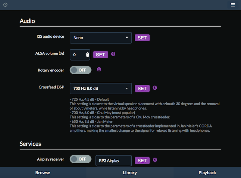

The next update is nearing completion and will include the wonderful Crossfeed DSP plugin and Buddha Radio 🙂
-Tim

Thanks for your job and time spent to listen me about crossfeed!
Hope that all headphones users can appreciate!

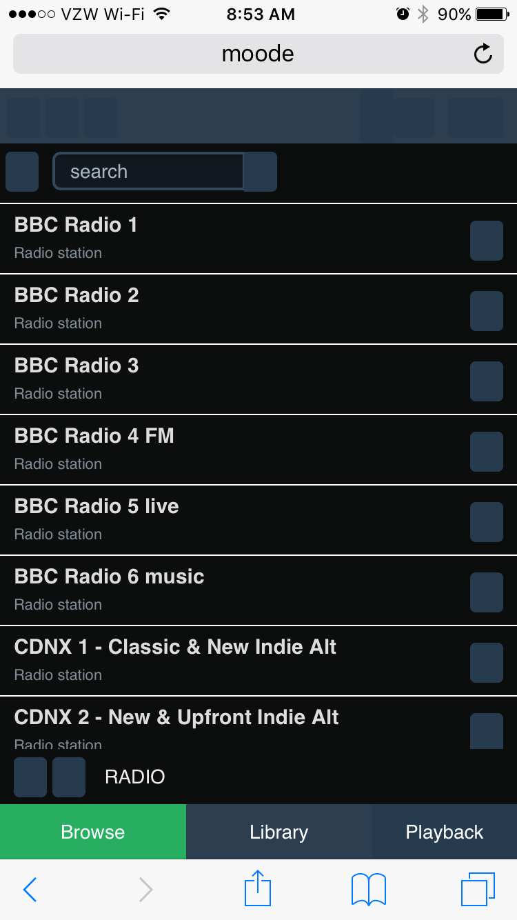

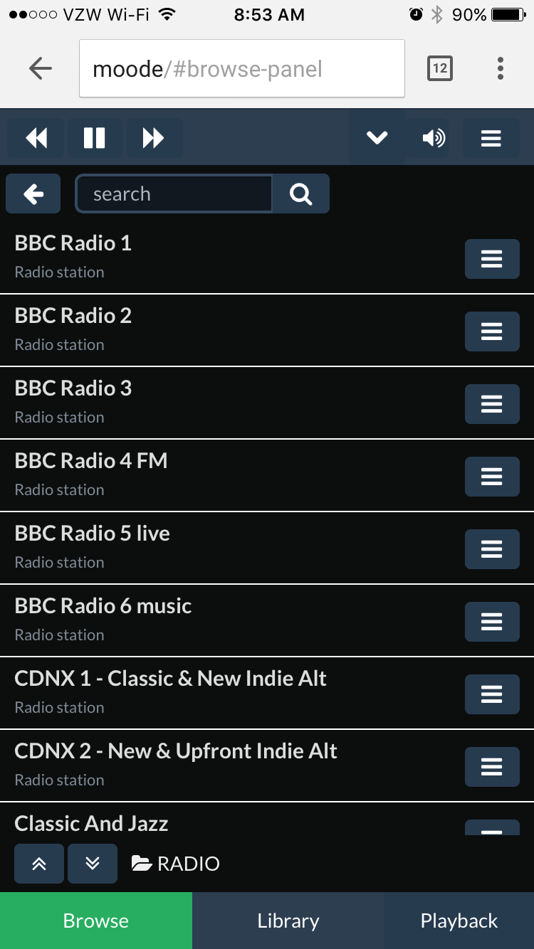

Hi Tim, I'm noticing the following bug in 2.6 (update release): when I open the web interface on safari iOS, button images don't show up, but in Chrome iOS the interface loads just fine. See attachments.
EDIT: NEVERMIND. The issue was caused by an advertising blocker that I had installed (purify). Interface loads just fine after whitelisting moode.local.
In Safari if u save Moode as a Home screen app, the UI will look much better 🙂
-Tim
