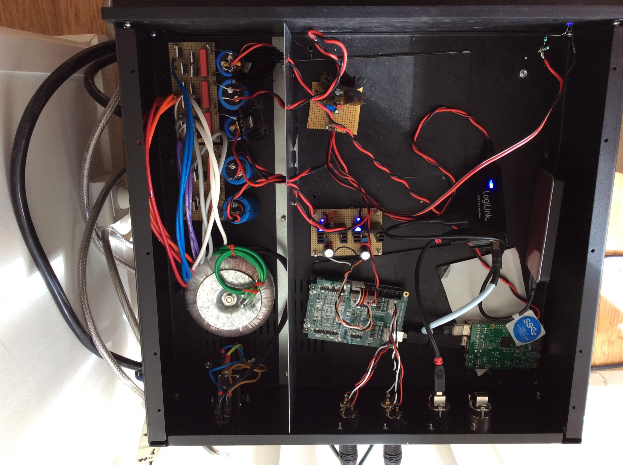

Thanks a lot - I'm looking forward to use at my new setup, build with a raspberry, Miranda dac and 5 separate lownoise power supplies - and with your software it is a high end digital player 🙂

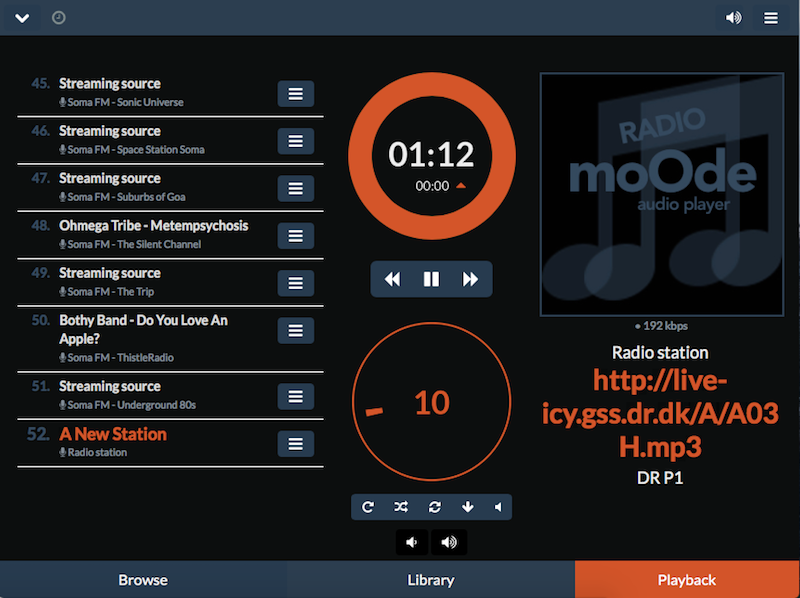

Hi 🙂
Just upgraded to 2.6. Now i cant create new radio station.
Ex. Adding http://live-icy.gss.dr.dk/A/A03H.mp3
Moode says updating in lower left corner.
Pressing play on new station and nothing happens. When i look at edit station. The url isnt saved (empty field)
Is this a bug?
Kind regards
Peter
Hi Peter,
I was able to add the station which would suggest its not a bug that u are experiencing. Try clearing Browser cache and history, then optionally restart MPD in Moode.

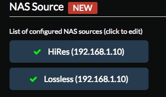

I've got another issue with new version (also yesterday's update didn't help).
The NAS folders dissappeared, library is empty, but the sources are still on the list (and marked as "ok").
I'm re-adding them to rebuild the library.
Any idea what might be the issue and how to prevent/fix it other than rebuilding the library? I didn't do anything to the configuration.

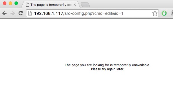

Yesterday, it was working perfectly. Today - I couldn't play music. The NAS folders were there but I hit "refresh folder"to be sure it's ok. After refresh (which took a fraction of a second) the NAS folders just disappeared from the list.
UPDATE: just tried to refresh the sources.
After I've clicked on the first one, got the message as per last screen.....

Tim
Generally, an abrupt change like you are describing suggests something external to Moode software for example a bad SD card, power supply, network, etc.
One of your screen shots shows Browser accessing Moode via IP address. Are u able to access it via "http://moode" or moode.local ?
-Tim
